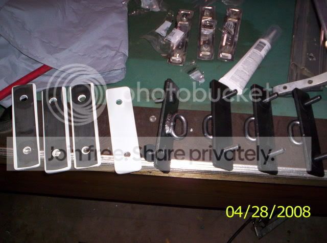

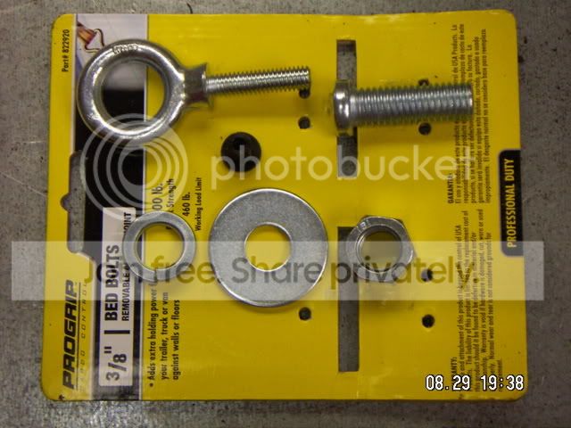

Now here's the beauty part. After searching for some time for hardware that could work, I came across EXACTLY what I already had in mind in the McMaster car catalog. Then I discovered that it's actually a commercial product called "Bed Bolt".
It comes 2 per pack in various sizes, this is the smallest one. I ordered two pairs from Amazon.com (actually "Sportsman's Guide").

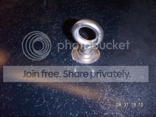

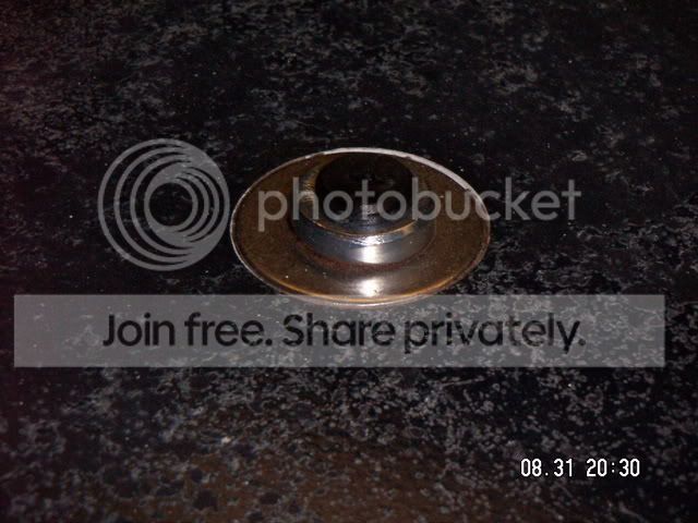

So the sleeve is threaded inside and out. I mount that permanently in the topper and then I thread the eye bolts in and out by hand whenever I need them.

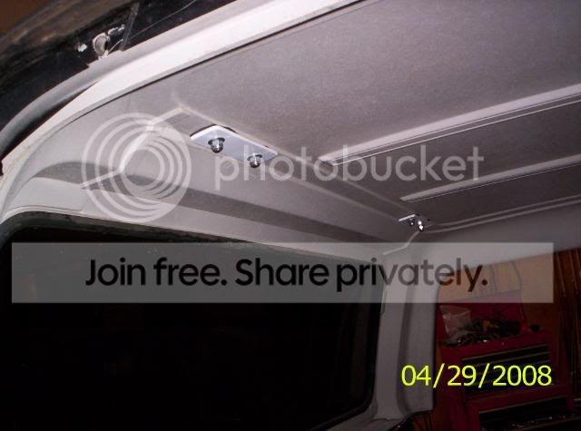

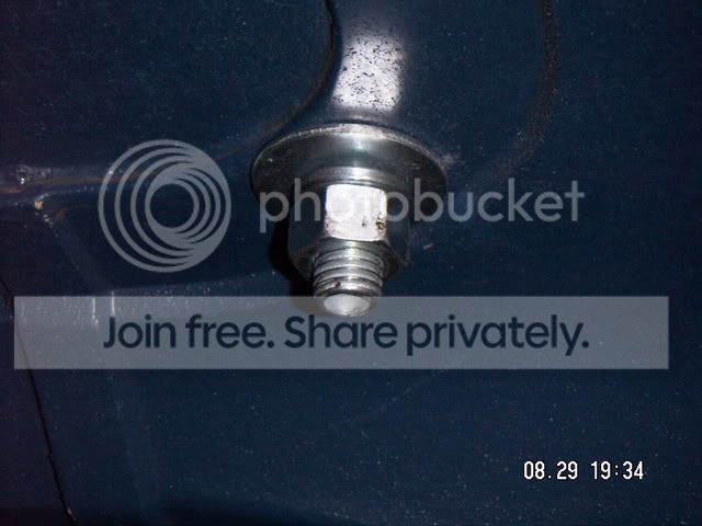

With the hardware issues solved, I was on to installation. I decided there was only one place suitable to mount them - in the "corners" of the hardtop where the inner and outer shells meet. This has a flat surface on the bottom, the total fiberglass is 3/8" solid and it's very close to the steel reinforcing ribs.

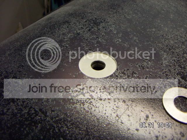

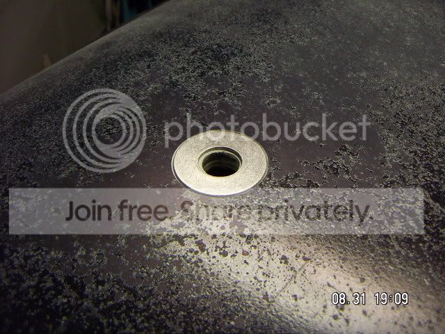

Since the top of the fiberglass is slightly arced, I cut a slight recess into the top. This helps keep the whole install low-profile, but more importantly gives the top washer a flat area to sit in.

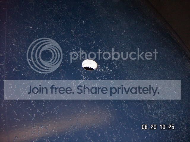

I drilled the hole a little small and then "tapped" it with the large bolt (you can kind of see the threads in the pictures)
The top washer is a thin stainless item that didn't come with the kit. I wanted something there to spread the force out (the kit is designed to be installed in a steel truck bed). I may use these as anchor points to carry stuff on the roof.
For installation I spread some "Bondo-Glass" on the underside of the washer and in the threads to make a solid and water-tight installation.

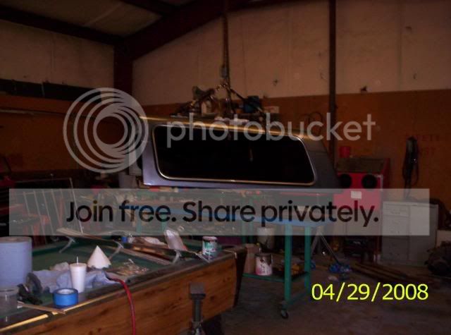

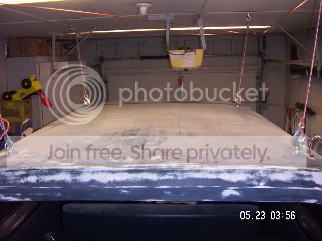

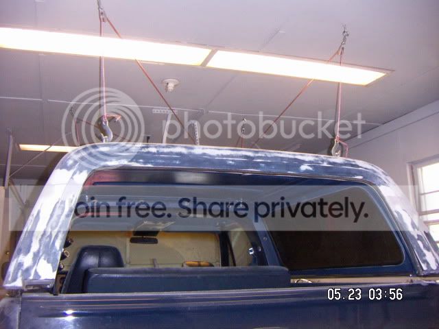

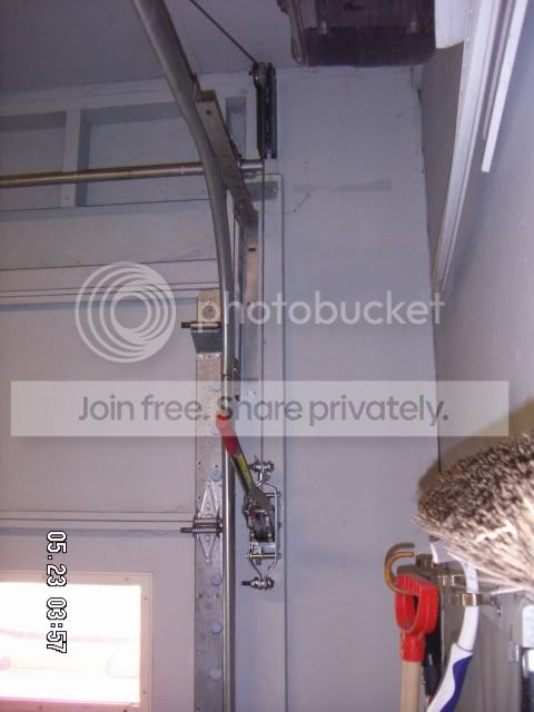

I never used this system to pull the top with ratchet straps. I am prepping the top for paint, so I figured it would be easy if I could use this to lower it to the ground.
So I used a come-along and about $20 worth of pulleys and such from Harbor Freight to make this system
The come-along has 11 feet of cable so I decided to make it possible to lower the top all the way to the ground. This required the wall pulley to be more than 5 feet away from the ceiling pulleys, so I put the come-along on the frame for the garage door, attached with 5" long eye bolts through 2 studs.
Here is a shot showing the locations of the hardtop bolts. Sorry the truck is such a mess, I am getting ready to paint.
This thing lifts the top directly from the truck. No more need to lift it from inside and put spacers between the top and the bedrails. Depending on how this works out, I may add an additional pulley near the centerline of the top. That will minimize the tipping of the top as it is raised and lowered, due to the angled geometry of the ropes.
EDIT: Look at the scrape marks on the top. It sits even higher than normal because the rear bumper, spare tire and side rails are off. I don't dare paint the top until I add some weight to the truck or ratchet the suspension down.
