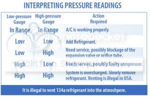

Seems like it might be a bit low. I'd try to bypass the switch again to get more definite, concrete readings. I think it's good to check it at idle and at a little higher than idle.
40 low 200 high would seem mostly ok, but 60 low and 250 high is off. Sometimes those compressors are garbage out of the box too.
Again, I think it is low. I'd try more, but keep an eye on the max numbers on the chart.

So I have added another 30oz of Freon, with the gauges closed and ac clutch engaged on its own 35psi low side and 255psi high side. Today it is 90 degrees out side and my vent temp at idle is 55.7
based on the chart my low and high side number are still low, should I keep adding Freon? I am at a total of 76 oz
