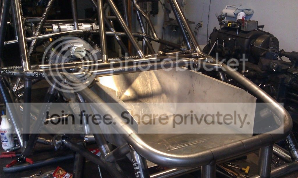

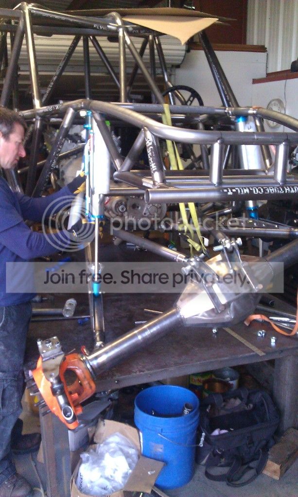

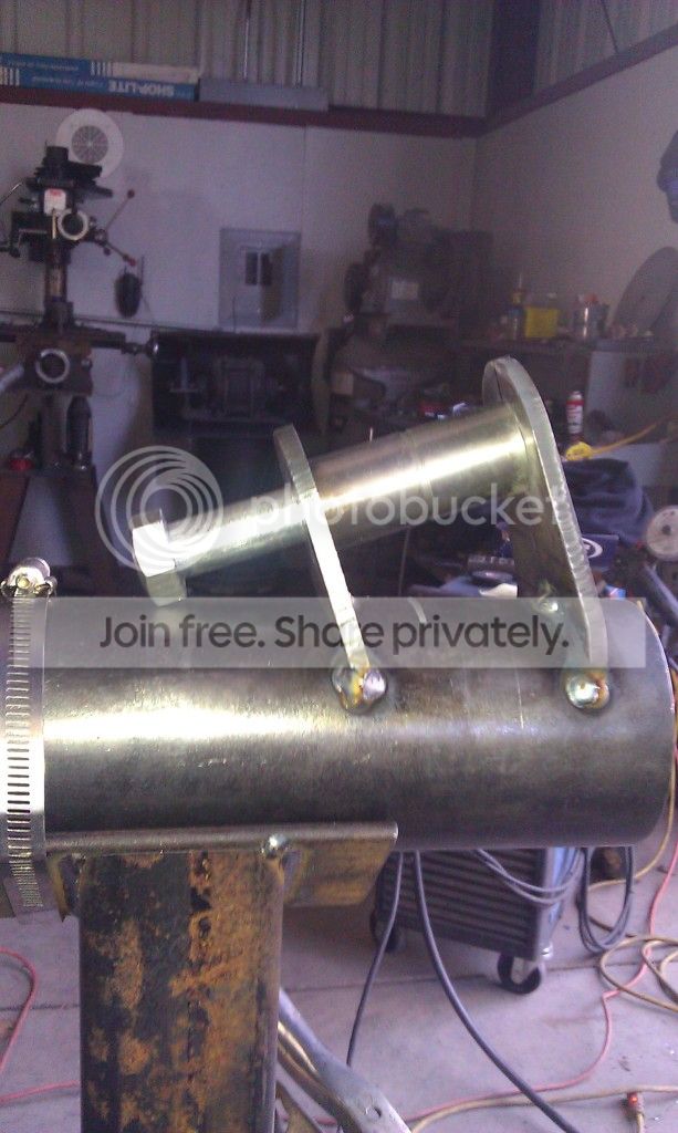

A few pictures of the KOH car we've been working on
Zeus33rd
Smarter than you
Mar 14, 2002
7,324
16
Grass Valley, CA
These pictures aren't in any particular order, but most are pretty damn cool, so I'm posting them up-

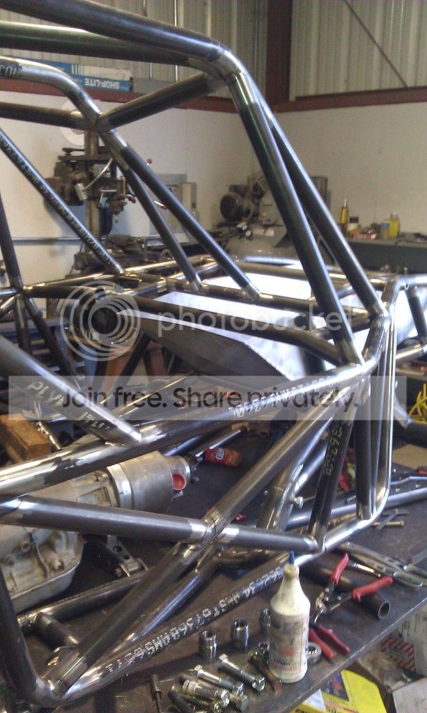

Nice looking chassis for sure!

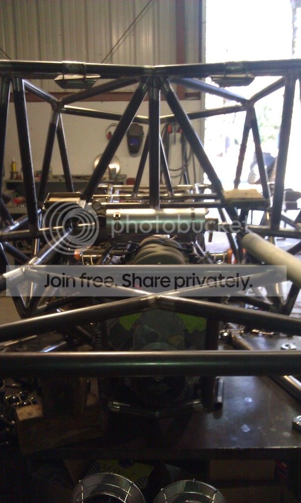

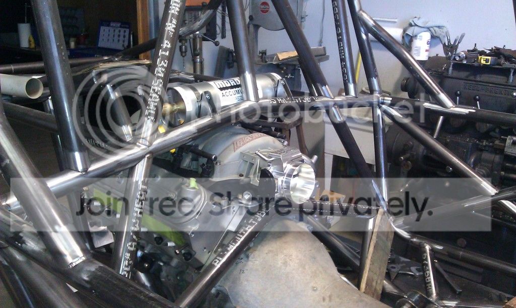

Looks like you have the parts to be competitive.....LS motor, th400, atlas, assume to be spider 9's or maybe rusty housings, mid engine, long travel......I think I am drooling on my keyboard.

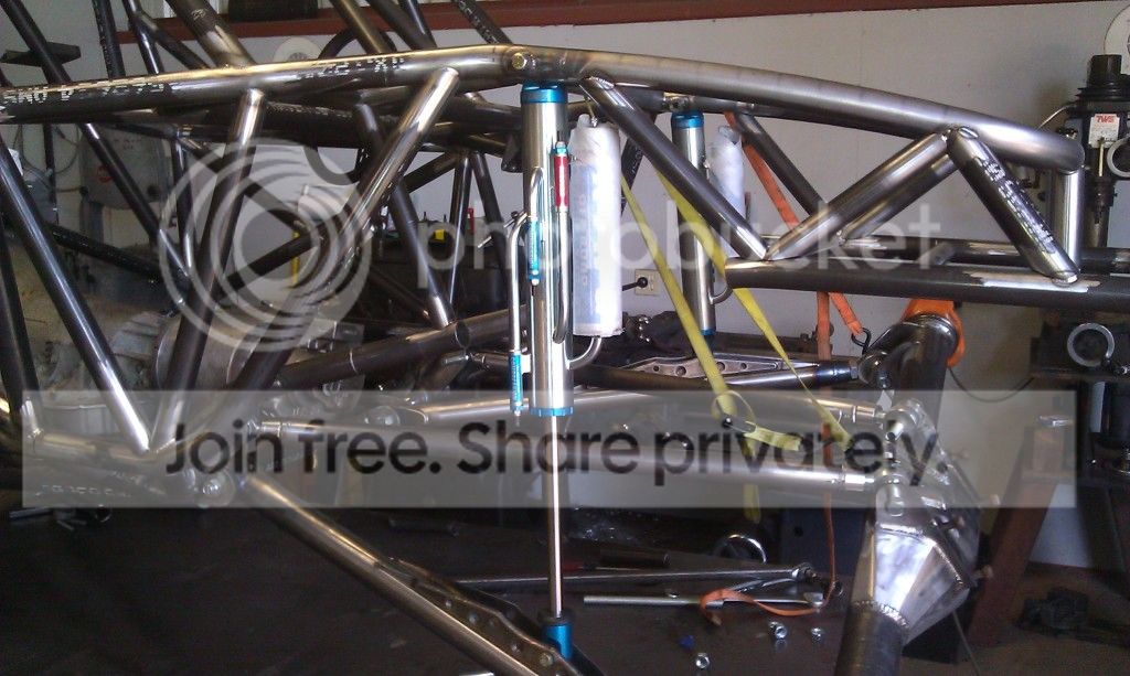

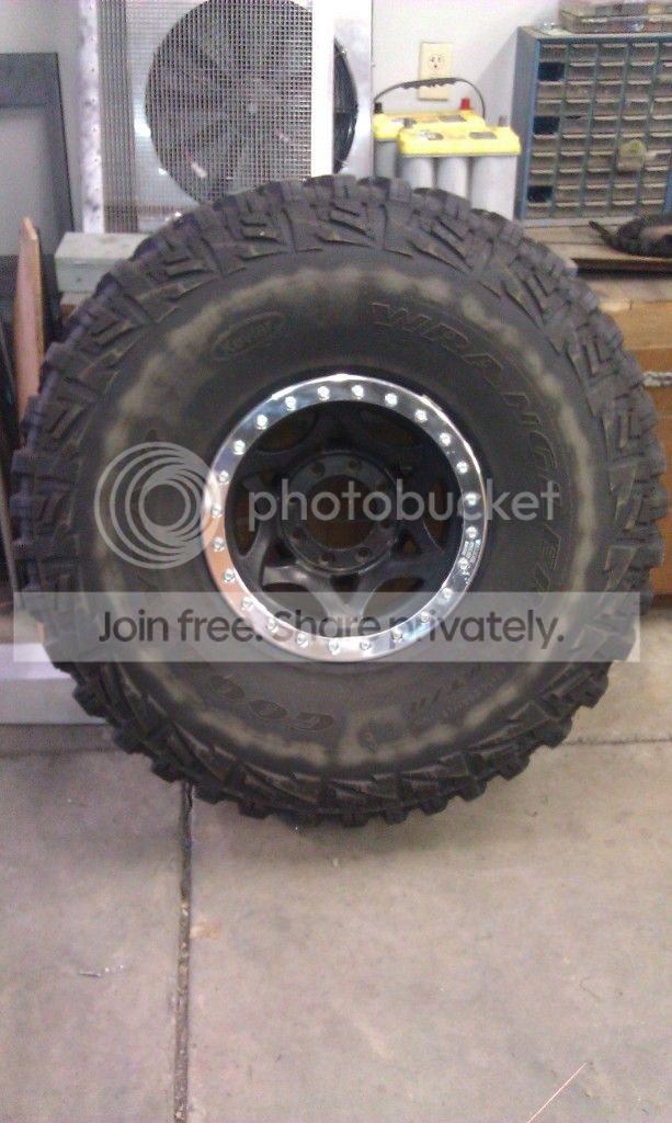

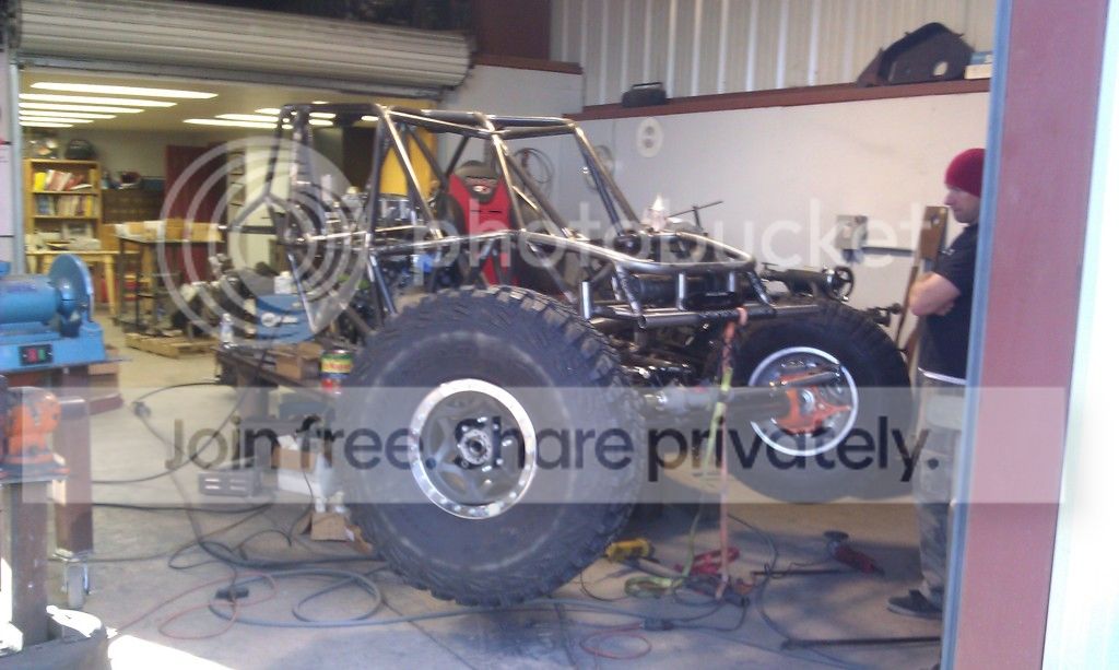

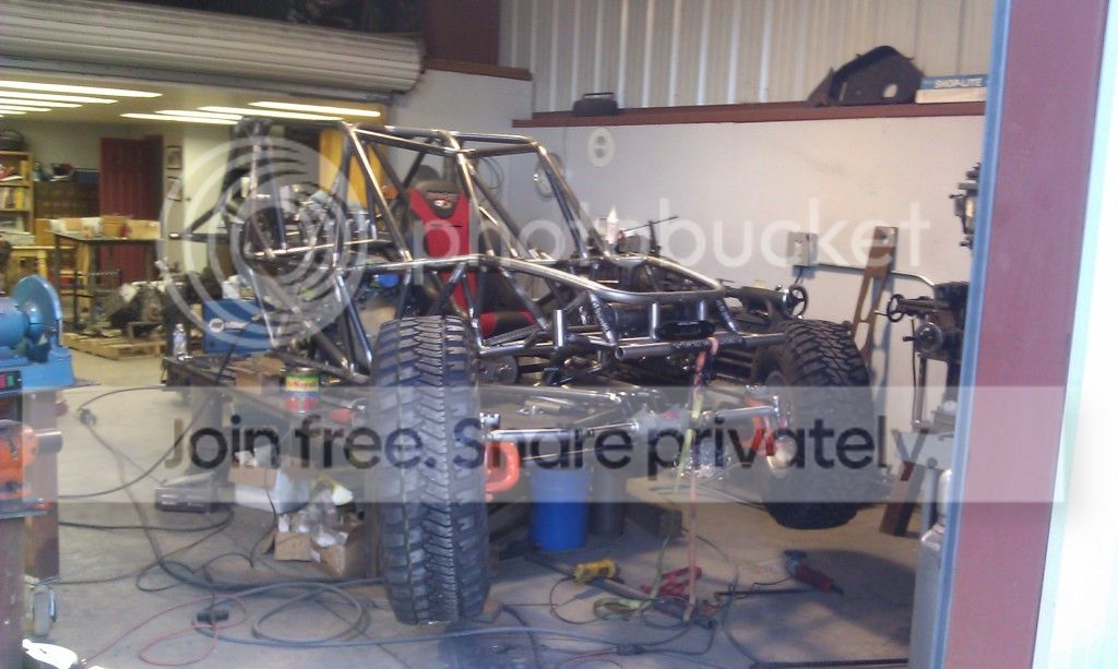

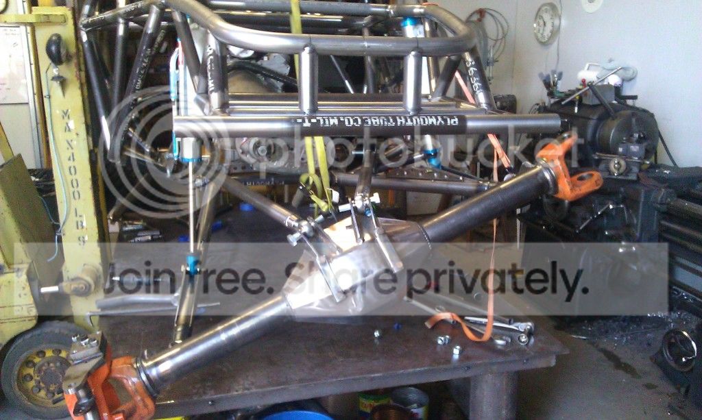

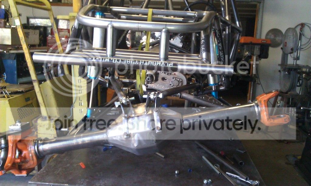

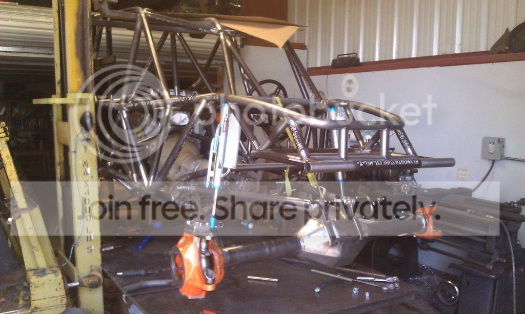

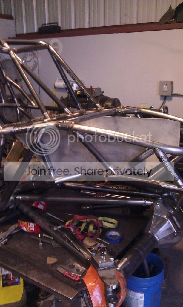

Car has to be in Vegas by 6am monday morning for exhaust, so my part in all this is almost done. Till race time of course. Today was fitting up the axles to measure for drive shafts, trimming the steering stops/adjusting steering and working on sheet metal. We mounted a 42" MTR to double check clearance. Will be running 40" MTR's for KOH, so the 42's were a good test of clearance.
These pictures are at ride height. 42 on the passenger side and an older 37 on the drivers side. 37's were just for rolling the axle's around the shop.
Kinda hard to tell from the pic, but the top of the tire is about even with the top of the intake on the motor...at ride height. :pimp1::saweet:
