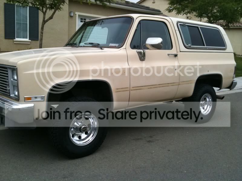

First time poster, long time reader. Here is a little vehicle info for you:
86 GMC Jimmy with Stroked engine from a 78 Blazer. Spring over lift, not sure the exact height of the lift. 32" tires. Old Tan paint and interior which the wife and I will be re-doing with a Superman theme, slowly over the next few years. Now to the questions. Keep in mind it's been 13 years since I've actually done any mechanic work so I'm a bit rusty in areas. Oh and links to threads with the answers are fine. I've done some decent searching but not found specific answers yet.
