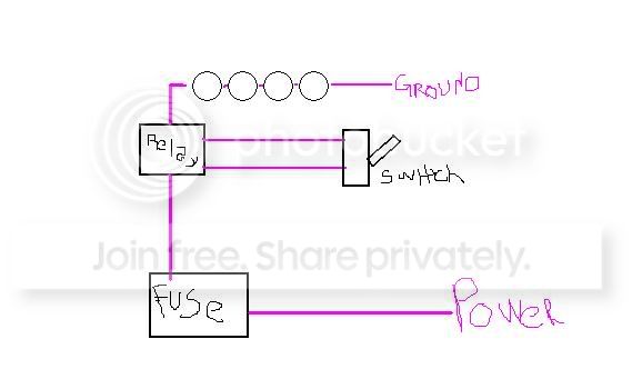

congrats, thats a hell of a deal. Steel horse light bar is what i have, pretty easy to bolt up. Where the light bar sits on top of that rain gutter lip, your gonna want to put something in between there, i had a little dynamat laying around so i used that, but some thing else of that nature would work. This helps prevent it from sliding and from metal to metal scratching. Wiring wise- i wired all of my top ones together, then only had to run 2 wires into my cab (through hole i drilled then siliconed- then i ran it down the a pillar and across up under the dash to a switch, then out to the battery with an inline fuse before the battery. Reason i did not use the relays was because i have a 160 amp alt.
this is my best guess...
would be basicaly the same but x2 if you wire them in sets of two.
