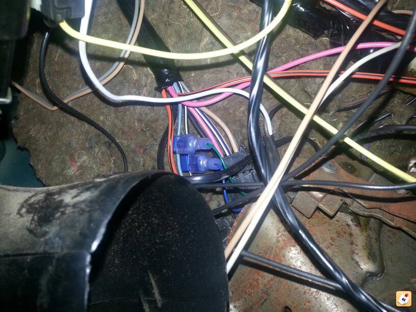

These cold Floridian mornings (Lmao) had got me wanting remote start in the Blazer. I hopped on eBay and purchased an Avital 4103 Remote Start/Keyless Entry System. Not knowing how it would function until after installation, at $45 I had nothing to lose. Took quite a while to probe the right wires and get everything routed the way I wanted. But I got it done, so here's a write up.
The wire connections are as follows:
Avital heavy gauge 6 pin harness:
*Connections made at main column harness adjacent fuse block.
*Used self-fusing insulating tape to protect my connections where wires were tapped.
Pink to Pink - Primary Ignition
Purple to Purple - Starter
Orange to Orange - A/C Heater

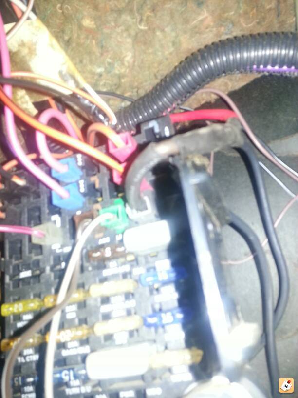

Red to fuse block constant - Power
Pink/White to Brown - Acc. Radio
*Disregard wire colors here, I made a sub harness.
Avital 9 pin harness:
White to Black at light switch - Parking Lights
Black to Ground
Brown to Black at main column harness - Horn
Avital 5 pin harness:
Black/White to Ground - Neutral Saftey
Purple/White to White at coil - Tach
Brown to White at Brake light switch - Safety shutdown

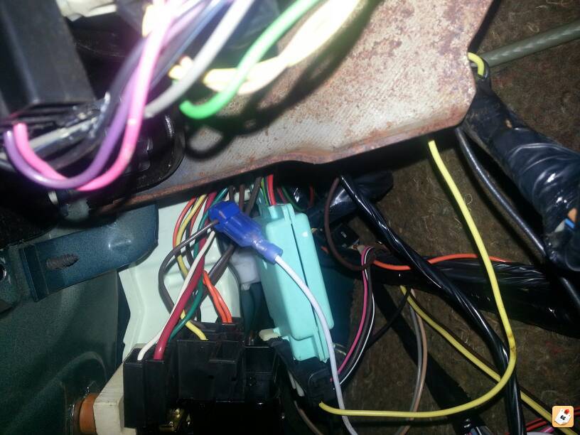

Avital 3 pin harness:
Blue to Blue/Black at kick panel harness - Unlock
Green to Black at kick panel harness - Lock

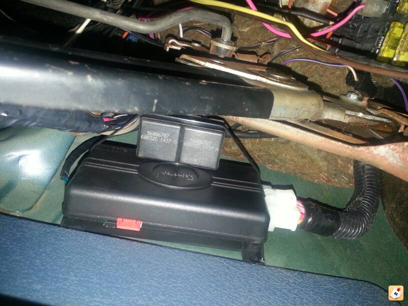

*I had to make a relay module (2 Bosch type relays) to convert supplied negative feed from brain to a useable positive feed that the locks require.
I mounted the Control module in the space between kick panel and parking brake assembly.
These connections are the only wires required to make Remote Start/Keyless Entry function, including horn and parking light confirmation.
