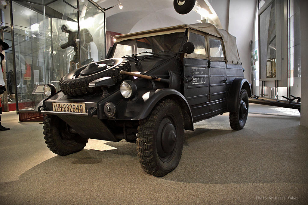

I thought of another flat body vehicle... the volkswagen Thing... here is a really cool version I found.
Thanks blowedupmotor! I agree.. I think both those vehicles are very cool.
That's a Kubelvagen (pretty much the same "Thing" (if you'll pardon the pun) though, it is the predecessor to the Thing) !Things are sweet!!! Here is a SICK one that is basically a Thing body wrapped around an LSX powered sandrail:

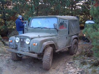

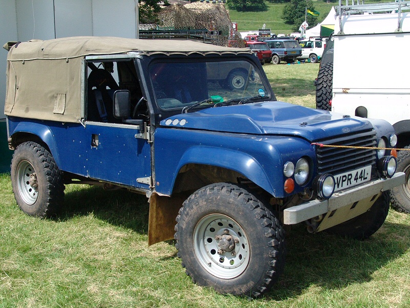

If you really want the simplest possible body- get a Land Rover Defender!!! Yes, you will have to learn how to weld aluminum to do hardcore repairs but, there are only two compound curves on the entire body! (the points of the front fenders)

I would like to take the body of the kubelwagon and the Land Rover Defender body and combine them.. I think the Defender body panels are riveted....

A frame for a Kubelvagen would be a pretty basic undertaking (two bent rails with crossmembers between them) BUT, adapting that body to go onto the frame is going to entail a LOT of fab work. Also, all the body mounts are going to get complex. Additionally, by taking out the unit body style floorboards to put the body on a frame, you lose all body rigidity and you'll have to build a LOT of reinforcement to such an extent that you'd be better off just building a rollcage and attaching the body to it.
For the Defender chassis Kubelvagen/Thing body- it'll be a TON of fab work to make the two of them work together and you are going to have to either adapt the floorboard of the Defender into the Kubelvagen body or make a completely custom floorboard. (either way a TON of work) There are other issues too- not the least of which is modifying the Defender chassis or stretching the Kubelvagen/Thing body so that the wheelbase lines up with the fender openings.

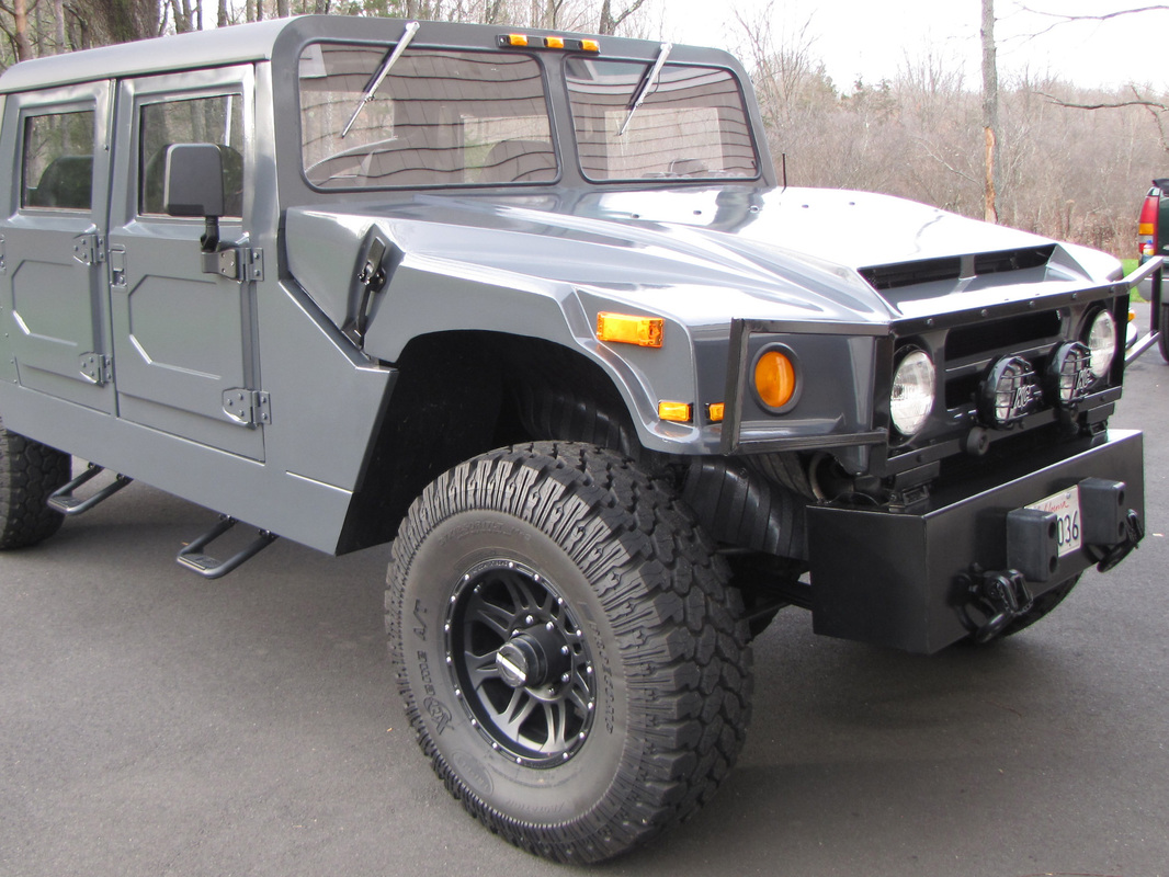

It's WAY bigger than what you are talking about but, have you seen the Urban Gorilla body kits? Like the one that Xtreme4x4 built? Here's a pic from their webpage:
website:http://www.4x4bodies.com/index.html
The best way to go IMO for this ^ kit would be a Suburban chassis, that way the dimensions (wheelbase and all) are most similar to an actual Hummer. Yeah, it's a knockoff (of a real Hummer) but, it fits the bill for a simple new body!
As for a simple, smaller body- it really wouldn't be too hard to design something that kinda splits the difference between a Kubelvagen and a Defender, it would just be a matter of getting the dimensions right to make it look right. The only real issue I see is the front spring hangers- both of the body designs you desire to emulate have VERY short front overhangs that may result in the spring hangers being forward of the grille. So, a conversion to a coilsprung (or blinger yet a coilover sprung) link type front suspension might work out better for the sake of the desired body lines. The rear springs shackle mounts might prove awkward to but, could always make them bumper mounted ala a Formula Toy. here's a pic to give you an idea of what I am talking about:
That hummer reproduction is very close to what I was thinking of.. I think I remember seeing those awhile ago.

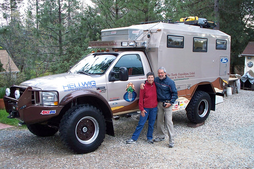

About the camper.. I have very strange ideas there too.. haha I get greedy I guess.I would actually like something bigger than the Action camper I showed in the video above because I would like something I could camp anywhere in like let's say I wanted to travel all over the US or if I had to live in my vehicle. I would want something I could maybe do some stealth camping in. With the pop up tops this makes it tough. Security wise too.
Check this out... I would like it set up a little different than this but the same idea. This merged with the action camper... But if I was to get remotely close to this size I realize I'd have to do a major upgrade of the axles etc so I don't know if I can swing that.
http://turtleexpedition.com/vehicles/turtle-v/
