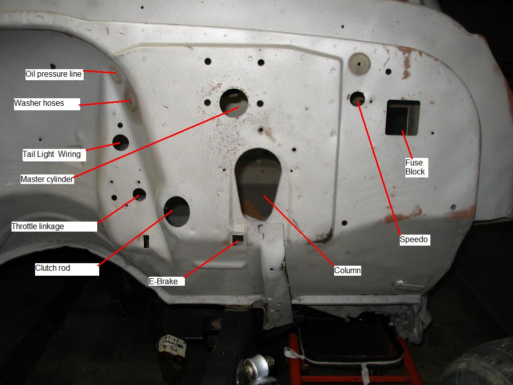

What are the supports shown in this pic called? The one right below the hole for the steering column?
