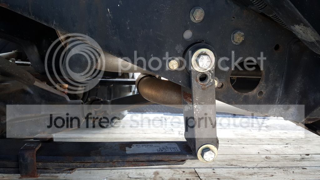

Good looking burb. My only suggestion is to avoid the 52s up front and just go with some of the better brand springs or ORD custom springs. I've had all of em and I'm back to procomp 6" springs in my dedicated rock crawler. More firm on the rates but that doesn't sacrifice the ride or flex. It does help it not be so floppy. Even with expensive shocks.
DO however upgrade your front shackle hanger and relocate that forward a bit.
I have moved my axle pretty far forward an needed to do this. But when I put it back closer to stock it seemed to ride pretty well. I would say a shorter shackle for your use as well.
I have my shackle in that same location with the ORD heavy duty shackles. I am running shorter 67-72 springs currently so with the front in the factory mount I had to move the shackle to get it to work. It also moved my axle forward a bit. Thinking of doing 52s or if I can swing it ORD custom springs or maybe just some 4" lift packs. I love your suburban. I might upgrade to something like that in the future when my boys all get too big to fit all of us in the blazer.

If you don't want to drop the coin on some high end springs I would recommend the tuff country springs in stock length. Then beef up the rear hanger with a FUSH kit and some beefier shackles.
Second (third? Seventeeth?) against front 52"s. They're great for rock buggies when you want insane flex, but for a truck that sees street time and/or speeds above, say, 30MPH ... not so much. This is the voice of experience :deal:
As to what you SHOULD use, IMO, do it once, do it right. Take your truck to the scales and get weights for both front and back axles. Then (and only then, as he'll ask about the weights :) ) call Stephen @ ORD, and decide on off-the-shelf lift springs or their custom packs.

As for springs, what springs are in the front - there is a world of difference between softride/ez-ride springs and all the rest. I get that you should check and make sure that your shackles are tending towards the back of the rig at rest - but if the springs are long enough, then the number or shape of the springs can make a huge difference. I can even illustrate. I had a square with 4" rancho springs and my brother roundly complained at how tough it rode (and it did) - he then criticized that I was "paying extra money" for softride springs.... until he rode in it. Softride even knows this is a thing because they sell just springs without bushings so that you can swap softrides for harsh-riding springs.
but with no pictures - I've no idea whether or not that's an issue. I think the PO value priced some things, so it would make sense he went with $400 Rancho system vs. $800 softride if he didn't know better (the bare springs are only about $150/ea from any of the online retailers)
