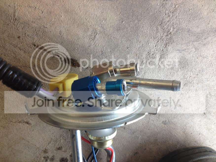

Here are the metric to 6AN fittings on a TBI sending unit
^This. Or, if you have a pickup version, I have found out on my crew cab that the saddle tank TBI tanks do not have the threaded fittings on the end of the sender. If you have the Blazer/Burban tank, then it will be as skunked has shown above. If not, you can still get AN tube fittings and sleeves and install them while flaring the tube, then install similar adapters to shown above. Either way, you can still accomplish what you need.
This has been done many times now, don't try and reinvent the wheel...these methods work
looks like he bought a blazer 31 gallon TBI tank and sending unit.

you'll probably still need those adapters that I posted above, they're specific metric to AN fittings. I'm not sure what fuel line and fittings you bought but those are 6AN fittings that I posted.

Yeah so you'll need those metric adapters to go from the sending unit to 6AN

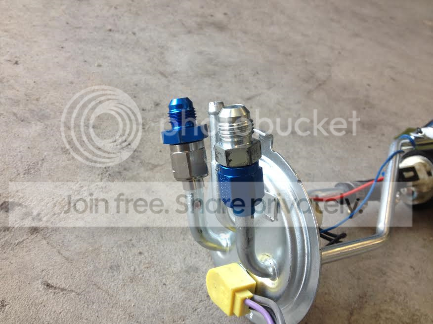

Just for reference as to what I was mentioning above, here is what mine was with the truck saddle tank TBI unit that does not have threaded fittings on the ends like the burban/blazer tanks
showing the tubes and sleeves with the flaring
showing the adapters hooked up to the sleeves
Now, there are a couple difference versions of these sending units. Some have longer ports that extend past the actual sending unit farther than what you see above. I would recommend if you are going this route to find one of those units (I found one on rock auto). It makes it much easier to cut and flair the line. I actually had to get the different sending unit after this picture above as the only way I was able to flair these lines is to bend them straight up, cut, flair, then bend back down. But in doing so it created a very small crack in the metal at the bend which leaked. Then I found the other sending unit on rock auto that makes it easier to cut/flair (link to that sending unit below). Live and learn with that one, :)

So now my sending unit looks like the above pictures but with the sending unit linked directly above. Don't think you guys are going the same route as me...but knowledge is power, haha
