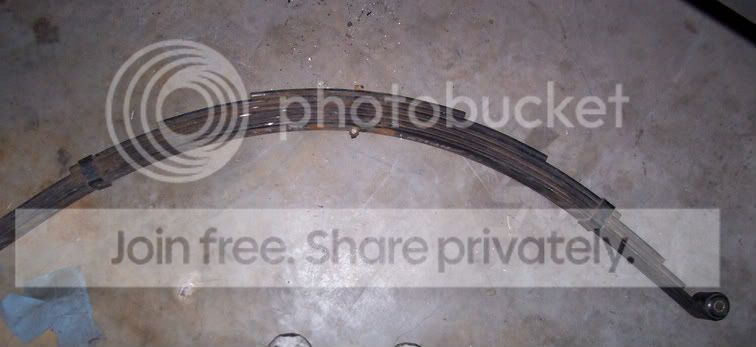

How thick is the add a leaf?
Heres my 8" 52
I think my add-a leaves were close to what would be the second leaf from the bottom of your pack... IIRC they were thicker in the center and tapered out towards the ends
