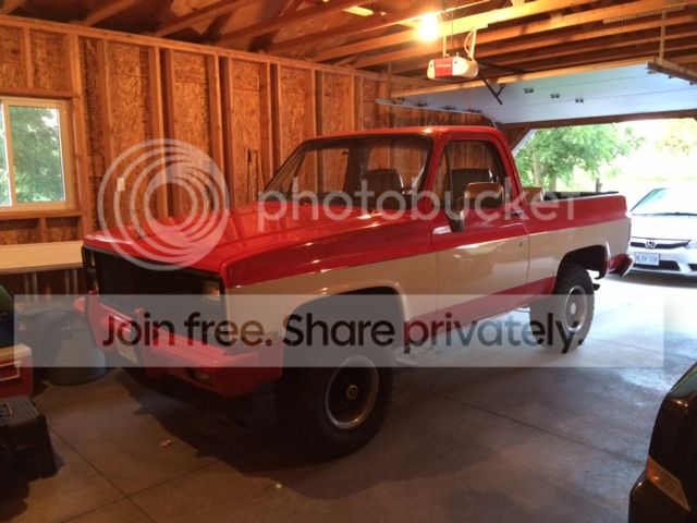

Hey guys.. My 84' 6.2L Diesel Jimmy is bone stock.. Its in good shape and runs beautifully.. The engine has been well cared for but there is some inevitable oil leakage that I would like to address.. This is my first diesel so please forgive this very elementary question.. Where are the most likely sources of oil leakage on a 6.2L Diesel?.. I'm an average wrench turner at best, but I certainly don't mind getting after things like this on my own.. I bought this truck to tinker with and get my hands greasy anyway, so what better way to blacken my hands than chasing oil leaks I suppose.. I'm not loosing a significant amt of oil.. But its obvious that its been leaking for years, as there is enough gunk spread around the motor from top to bottom that I can't definitively say where exactly all of the leaks are coming from.. The more info the better from you guys who don't mind taking the time would be fantastic.. Pictures and any tips or tricks for doing the work is appreciated.. Like the easiest way to remove parts for access? - what needs to be removed and what doesn't to get at a seal or gasket? - Must have tools? -Gasket application best practices? etc.. I'm sure any other 6.2 owners who stumble across this thread will appreciate it too.. So thanks in advance for any info.. And since I haven't yet posted a pic of my truck on the forum since joining.. Here's one!..
