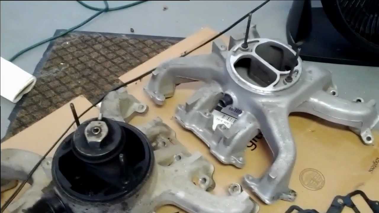

This is what C-code and J-code manifolds look like. Aside from the EGR passage & valve, they are very similar. In this case, the J-code is an '82 or '83 as it has the mounting boss for the secondary fuel filter at the rear (84+ rigs have only one filter so this boss was eliminated on later models).
