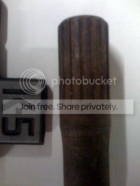

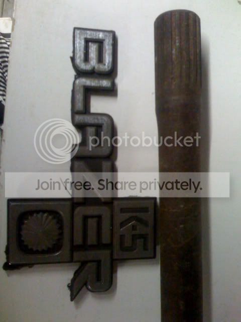

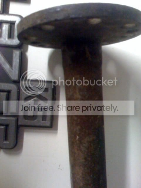

you can but I dont know why you would. here is a pic of my spare eaton shafts. The only reason I have spares is they came with the axle when I bought it.
Well, from the looks of it my 14bsf shafts are bigger (they're bigger than ff shafts too :D).
Second, it looks like someone already twisted the splines on the shaft in those pics. That's probably why they are spares :doah:
