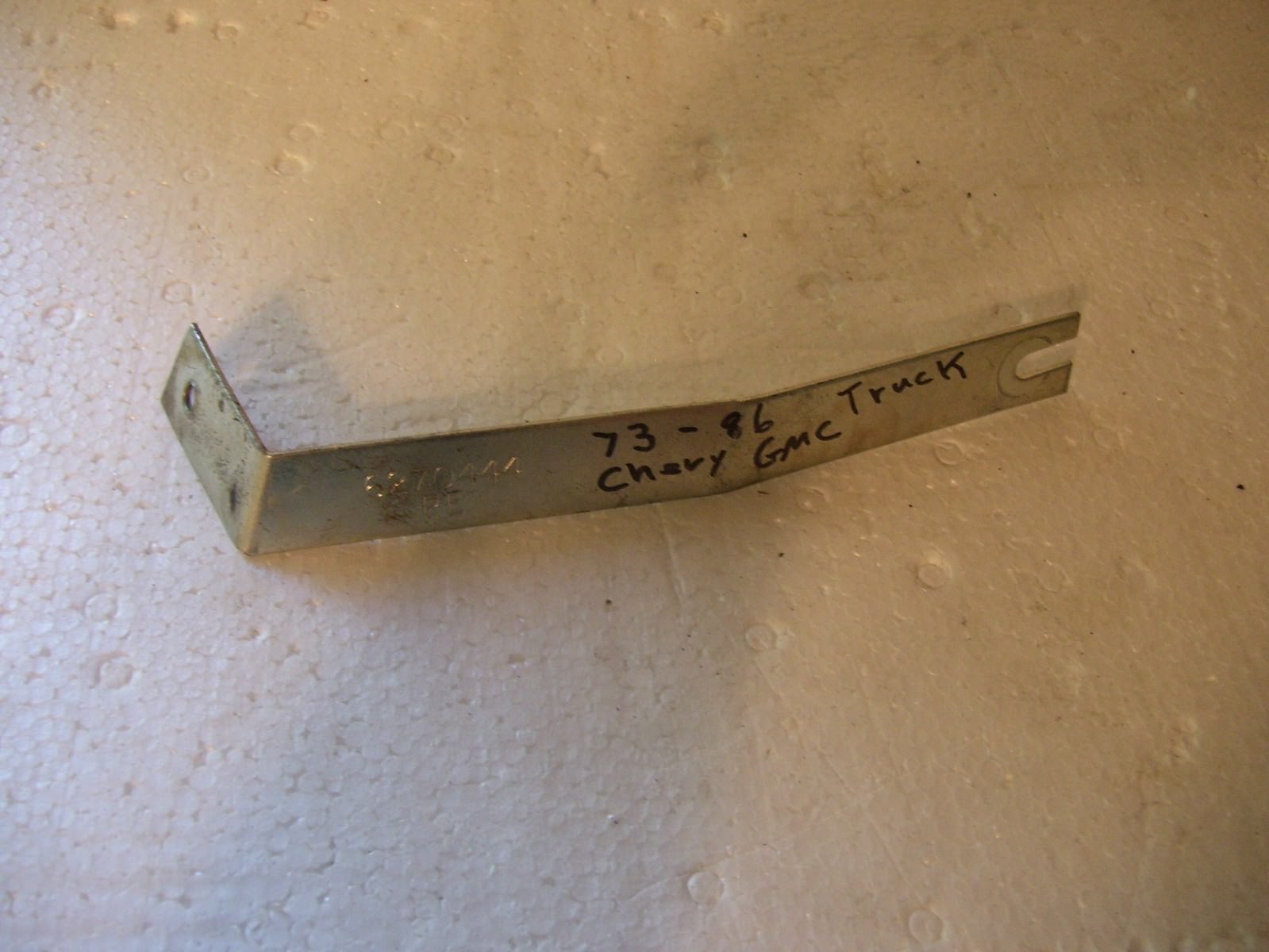

here is a picture of a GM factory bracket that holds a radio in place. They may not work for an aftermarket radio because they may not have the mounting stud in the back of the radio to use this bracket.
It would probably still work. Aftermarket radios have a threaded hole for these types of mounting.
