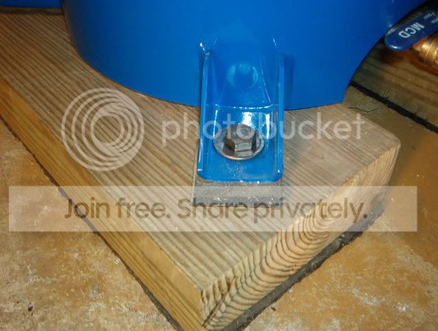

i always just freestand mine... here's my Quincy with isolator pads and lumber...

Thanks for the replies. I don't know how much it "walks around" - I have always had it bolted down. I think that I will try something simple like the pictures ryoken posted.

mine is setup like Ryoken's except without the isolator pads, just wood.
It works fine and is pretty silent.
my last screaming banshee was on the delivery pallet for 15 yrs.... the only reason i went a little fancier with the Quincy was to keep it all a little cleaner install , floor space efficiency, and the old pallet was difficult to keep from getting lots of "cr@p" under...
