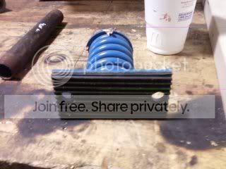

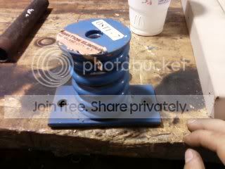

Anybody ever try anchoring with something like this?? We have them at work and they have "vibration eliminator" written on them. I think that would be a pretty neat effective ancoring idea :thumb:

those are isolation mounts for sure. I use them in all sizes, mounting gensets on top of fuel tanks or gen skids on pads. Those look like cheap ones though. I mean seriously they welded the spring to the base. the good ones the spring is free standing but caged. and there is a separate base and top and you use a jacking bolt through each one to level your piece at each mount.

Yah they use these ones for mounting squirrel cages at work, reduces vibration noise, not really meant for alot of weight. Im sure 4 of them on an air compressor would work just fine :thumb:
