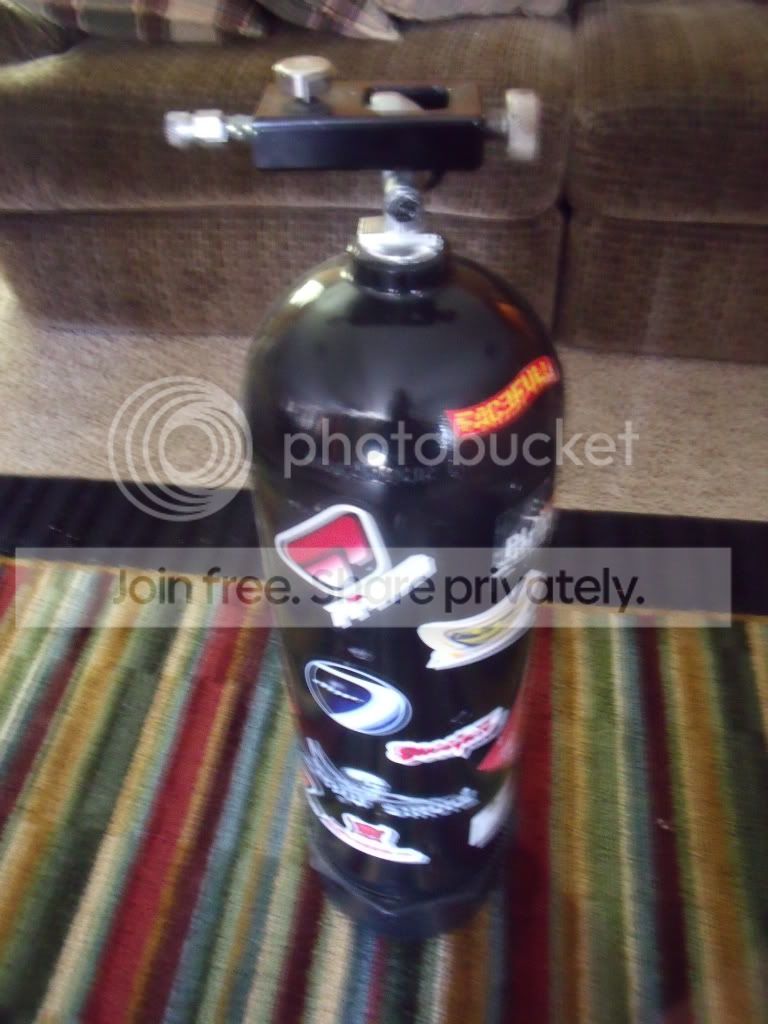

Heres my scuba tank (used for paintball fill ups)
Im gonna mount it on round brackets behind my rear seat, its even got the adapter on top for quick disconnects. Should work great, i forgot i had it lol.
