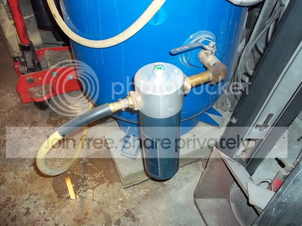

I run an oldschool binks I got cheap on Eghey right off my tank and VERY rarely get water.....
one of these days I'll actually plumb a true system...
Thanks will look into that. My compressor is little different from yours as where your valve is in pic my is up top.
that's even better.. farther away from water in the tank... the compressor may be creating more heat than mine, thus more water...
