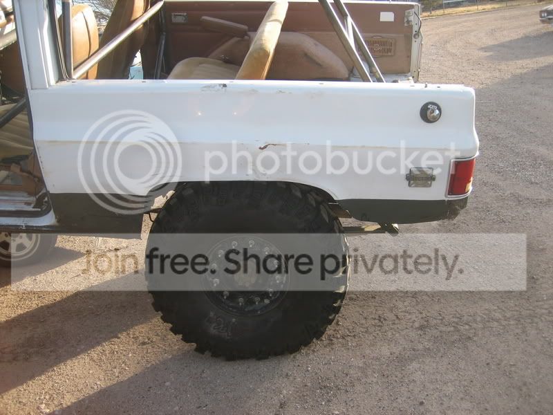

What size tire do you plan to run? Did I miss that part lol? I was running a DRW D60 and a van width 14FF with H1s until I went to 42s. When the rear flexed the tire would hit and rub the inner rear fender wells. I added spacers to the rear only because they were basiclly free. I was going to mini tub the rear or just live with it for the moment.
Thats without the spacers just to give you an idea!:D
