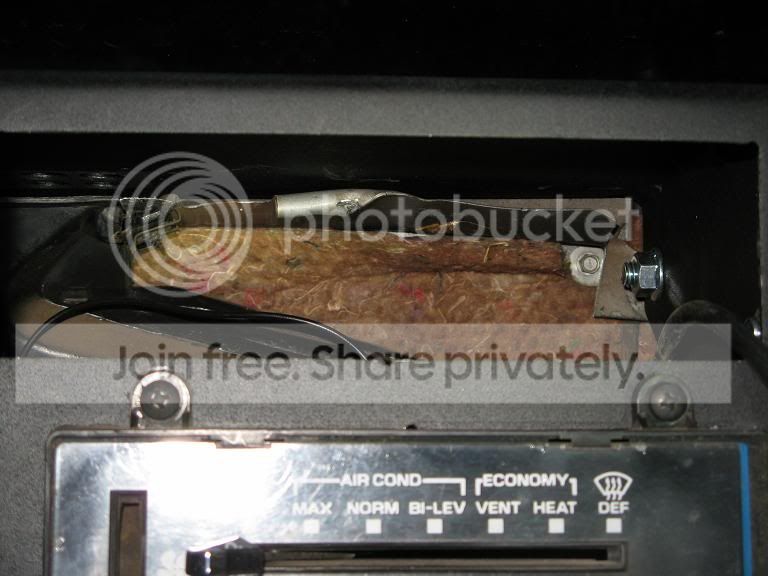

k85 octane can you get a pic of the back side of the lower panel were you got the switches ?
and if possible measurement from dash face on backside to closest object stright back from the face of the dash .
i got a federal signal switch box i was going to mount up in there and by your pics sofar it looks tight .
in this pic you can see were i am wanting to mount it
