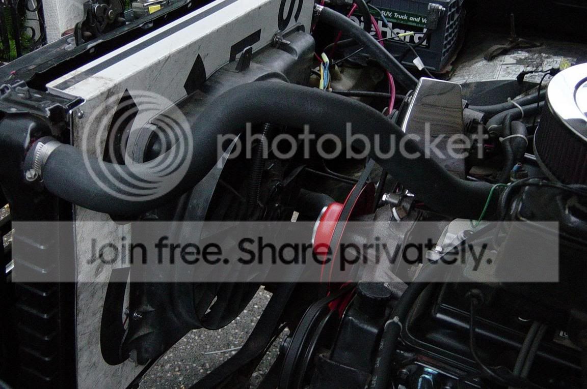

Heres what my fabbed shroud and taurus fan look like. The fan sucks some serious air, but the shroud could use a little improvement.
That is too funny! Nice choice of material! :D
