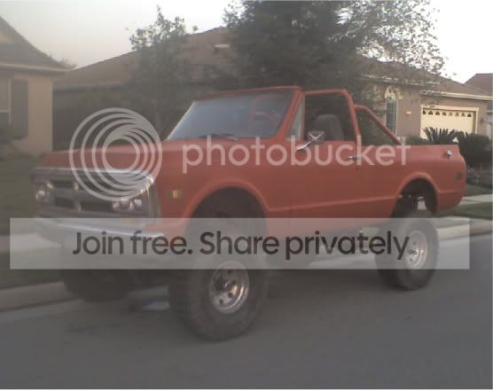

So, my jimmy likes to eat u-joints. This is the 2nd one in less than 30 days. This wouldn't be so bad if it didn't take the yokes with it when it does this. And I am like most people, in a financial pickle, and need it fixed ASAP. And I have the new u-joint, but I can't track down a yoke for a reasonable price. I was contemplating going to pick-n-pull, but before I go, I have a question; is the yoke from a NP205 the same as from a 70's 2wd transmission.
Aslo the jimmy is a 71, the yoke that failed is the one on the t case that goes to the rear axle, and I need it fixed before Friday.
On another note, this is sad, the jimmy just got painted and is topless... but she can't move :(

its gunna rain man!! FWD that thing under something! lol
I drove it home in 4wd, and boy did I piss off some people that may have been in a hurry :D. and its got a big tarp over it now, and if all else fails the interior is bedlined and its not like the seats haven't been wet before and theres no radio or any fancy electrical stuff in it.
