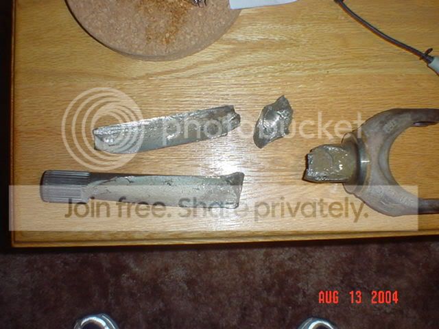

- stubs - I grenaded 2 30 splines and found a 3rd very twisted before swapping to 35-spline. This was with a stock low power 6.2 diesel, automatic (less shock), and 13/38 tires (closer to a 36x12.50)...and I don't consider my driving style abusive by any means.

I did the same basic thing. Should have also mentioned I broke a necked down inner before replacing them with new Spicers. So a total of 3 breaks using OEM stuff. The breaks all happened on out of state trips and put a big damper on them. The inner was midway through the last day and I didn't have a spare anyway so just cruised the easy trails and watched everybody have fun. I had spares for both stubs but still wasted a couple hours each time fixing them while others were wheeling (a complete spare shaft assembly would have been much quicker as half the time was spent popping the broken stub of the u-joint and replacing it). My point being is that it sucked losing time on an out of state trip doing repairs, and fixing stuff in the field sucks just as bad.

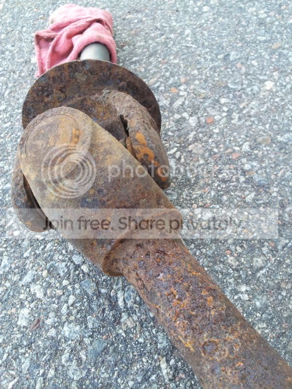

Well, I am really confused here about if doing axle replacements is overkill but I suppose if I am to err, it should be on the side of caution. I won't ever regret spending another grand on the axles while I am flogging this thing off road eventually is my guess.
I'm also having a harder time as I go justifying using axles looking like this, even though those u-joints would be replaced ---
