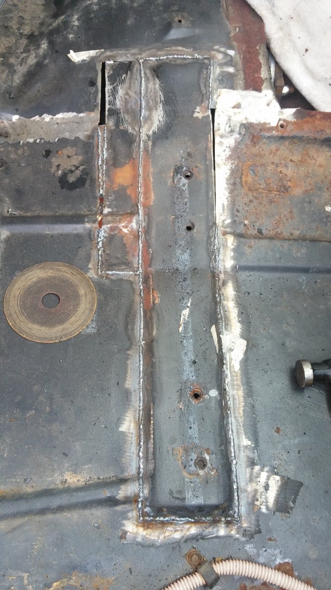

This is the hole I started with. I just started flexing the metal up to create a hump to make room for the t-case and trimmed off the excess then welded it together. Wound up with this so far. I'll get the seat bracket cut down to fit the holes that are three and hopefully be back in business!
It's not very pretty and the tunnel cover is going to be a trick to get to fit, but I think this will work the best and get me back on the trails the quickest. Get this done and then I've got a dozen other projects to get to but I want this done first if possible!

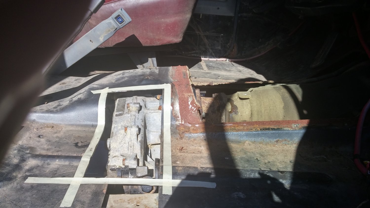

First thing I'd like to say is......body lift. Do a 1" body lift if you don't have one already. This is going to be so much easier with it. I can't comprehend the PITA you'll experience with the trans tunnel and T-case linkage if you keep it stock. Look at this picture and you'll see what I mean. There is no room for tools or hands.
The passenger seat can be left in place easily. Just be careful where you cut. The bracing for the front mounts is RIGHT IN THE WAY. I don't have original seats but I am using the front bolt holes. If you cut little by little, you should be able to save the mounts. In this picture, you can see a bolt hole drilled next to the opening. The original mount is gone, only a couple inches back from this this hole. If you look real hard, at the right side corner, you can see part of the mounting hole.

How high above the floorboards is this...? I have the 1" body lift but I have an internal cage (seats mount to cage) that I have to work around.
It's got a 1" body lift. The T-case is a smidge above the floor board but I pushed the drivetrain up higher than normal. My trans mount is now ~ 1/4" above the frame rail. So if you build your crossmember to keep it in the same location, you wont have floor issues. However, having the cut out will help some with getting the linkage worked out.
