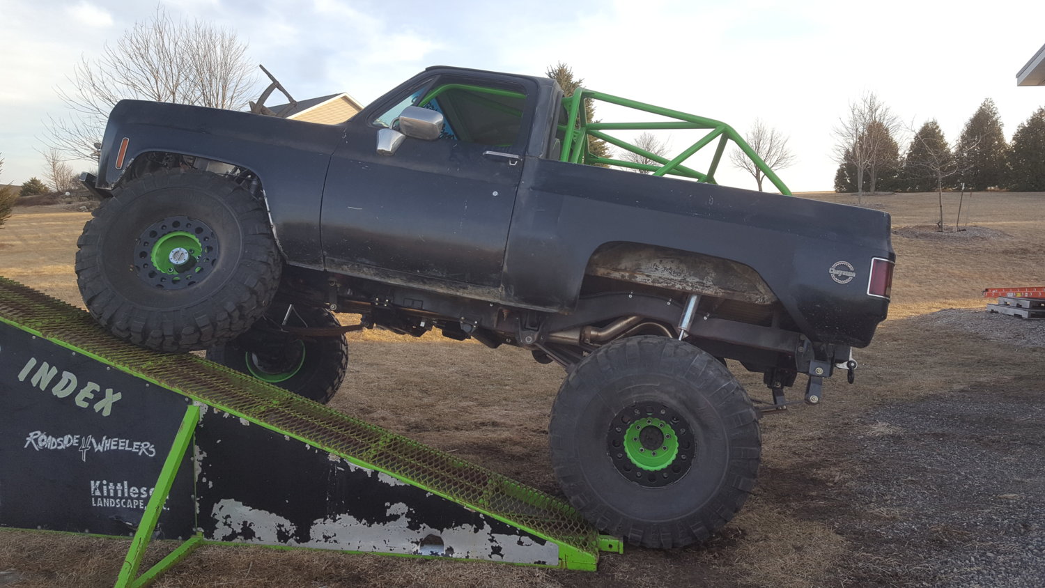

So I'd limit your springs so they don't flex past dead flat.
That's a 5 leaf pack with the overload exactly where it is factory

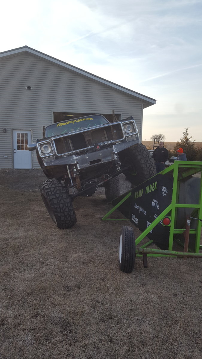

Looks like your truck flexes pretty good, I wouldn't mess with the springs. Just get those bumpstops where they need to be and drive the truck. As you use it, then you will see what needs to be changed/altered.

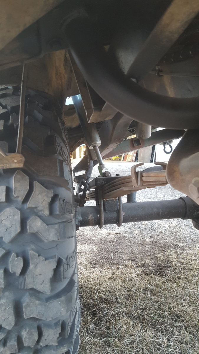

That's the plan. My worry is that the slider between the main leaf and the 2nd leave must of wore out many years ago and the end of the 2nd leaf has wore a groove into the main leaf. It seems like it will be a short time before it fails, probably at the worst time. They were all I had laying around many years ago when I started this project.

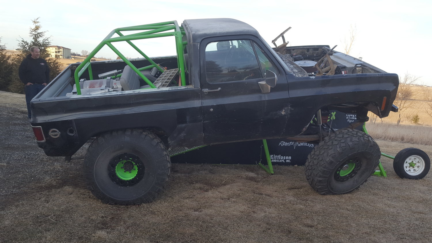

I did do some searching and found some information, but I'm still looking for a consensus on what to do with the overload spring from what I read definitely want to keep it in to act as a bumpstop. Is it a good idea to turn it upside down. so that the curve is downward rather than upward opposite from normal? Wrap isn't a concern as I do have a traction bar.
I was able to get my truck on a ramp this weekend and see how it flexed and I can see where you can easily bend the springs by over flexing.
Also what is the best 63 spring pack? 3 plus an overload 4 plus overload?
My rig is a K-5 no topper, full cage,boxed frame,2 propane tanks in the rear. Other than that nothing more weight wise or than normal.
attached a few pictures on the ramp. just because pictures make the post better
