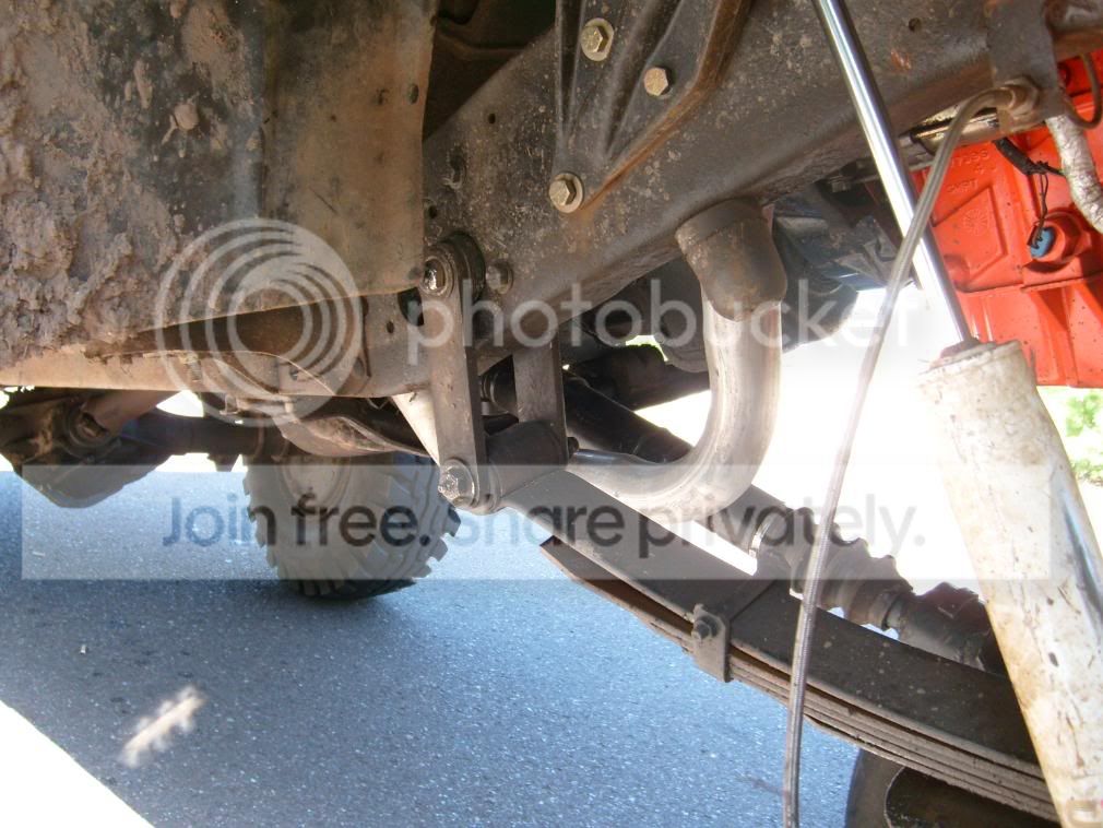

This is the setup i am running and i have not had any probems and to make it worse i have a 5.3 which moves my trans another 1.5 inches forward, i have maxed out my springs with no binding
Nice flex out of those bad boys. That picture is enough to get me started on the swap!

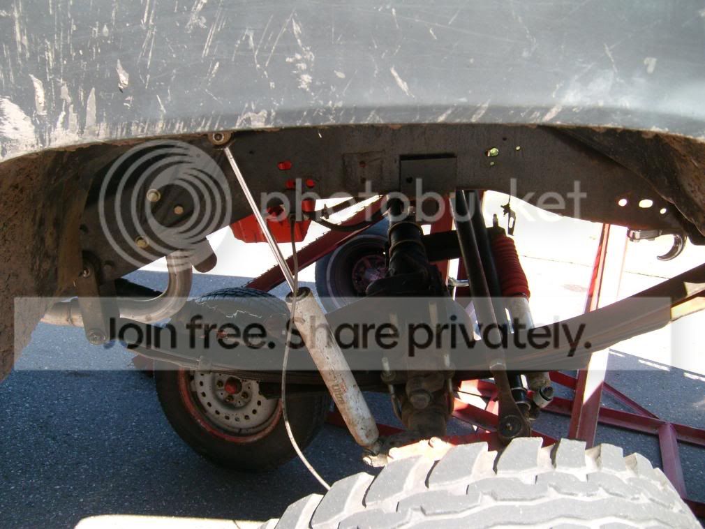

heres a video of mine drooping, but not maxed out.. 56s on the front with a boomerang shackle, duel shocks and 4.5 inches of lift..38 inch tires.
for some unknown reason I get zero spring wrap.
