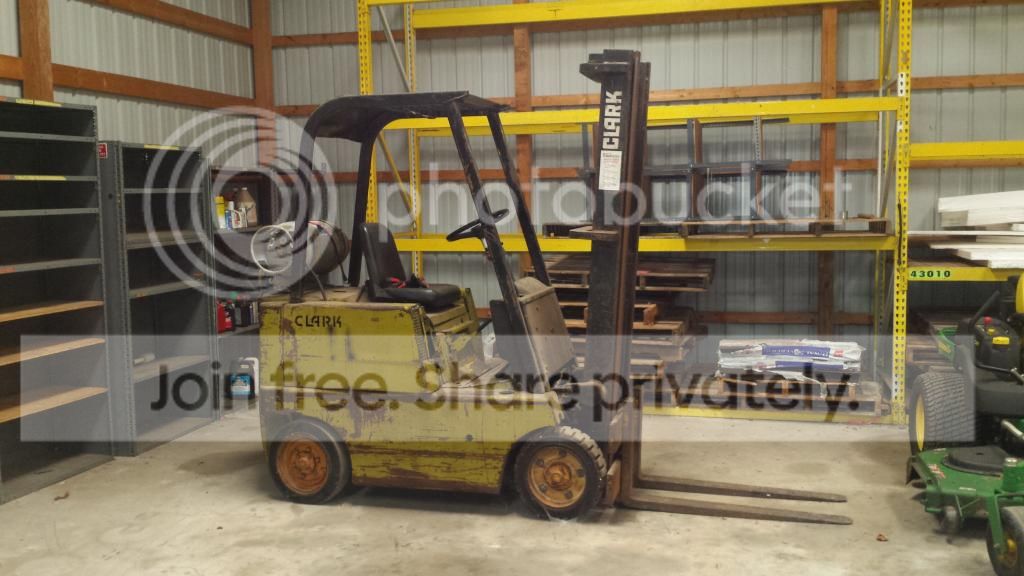

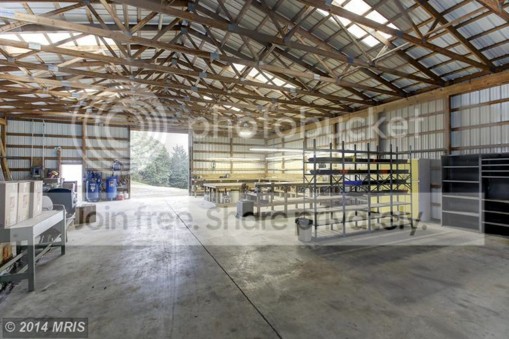

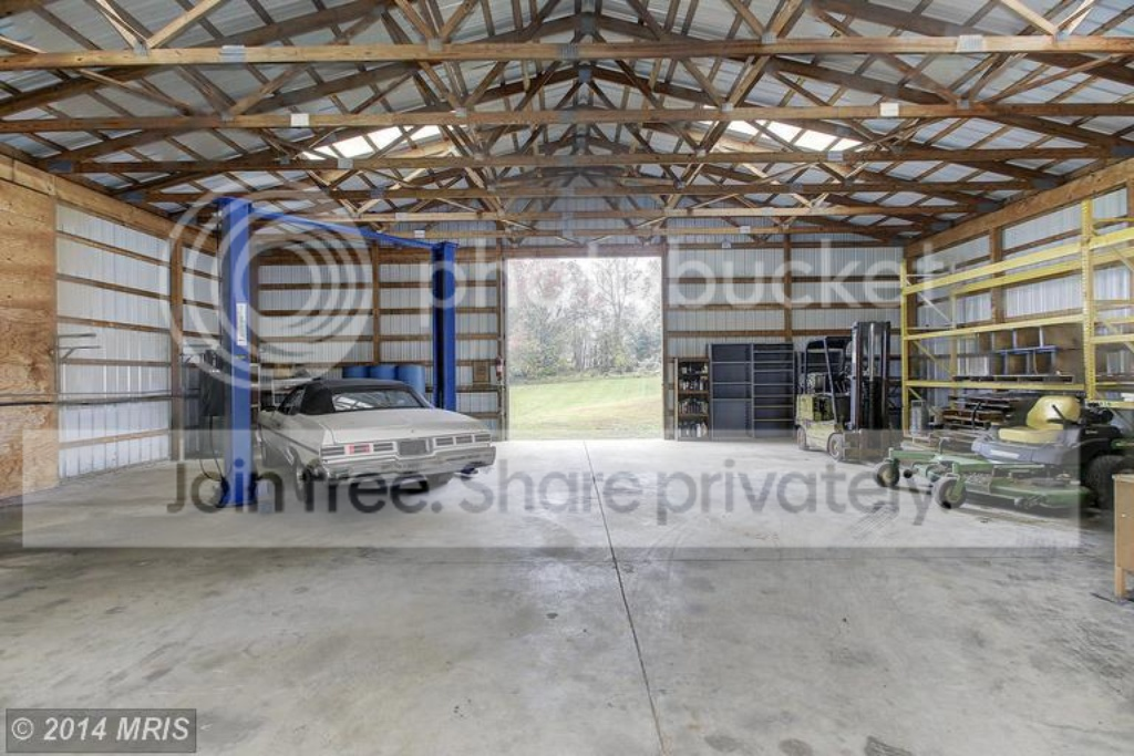

So we just bought a new house that has a huge 50'x80' shop.
(More pics in my build thread)
But anyway they threw in the forklift that he was using and all of the pallet rack and shelves which will be awesome for storage.

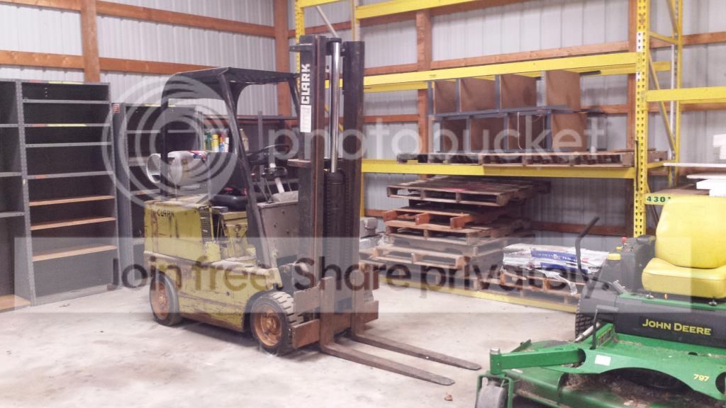

Anyone have any idea on a model number or approximate year? I didn't get any great pics. I looked for a ID plaque but could not find one. I am guessing it is a lighter forklift (2500-3500 lbs)but it would be nice to get some more info on it. It is propane and it looks like it was gas originally and converted to propane. It is supposedly fully operational and does not appear to be leaking anything. Battery was dead and it was like 13 degrees in the building so hopefully I can check it out in more depth the next time I get over there.
Any thoughts or info would be appreciated.
Not sure on the exact year of yours, but one company I worked for I got tapped to come help pick up a used forklift. The caveat of course was if it turned out to be a POS it'd be my fault. I picked the exact clone to what you have there. Lift rate was 5000 lbs. There will be a rate tag on the dash showing max loads, and distance from the mast.
Conventional OHV 4 cyl on propane. No conversion, they're built that way from day one. Ours had about 3500 hrs on it when we got it, and with minimal maintenance it still ran and worked like a champ 4 years later when I left. Had north of 5000 hrs on it then. I recall the only real money we spent was on replacement tires. Easy to spin on the smooth concrete, and nobody was easy on it...
Seeing as it'd only be yourself, and not in a production environment I'd guess the tires and the rest of it would last a lifetime for you. IIRC we paid $4500 for it.
Not a forklift expert, but man that's one helluva shop you got there! Congrats!
THIS!!! WOW, dream shop BIG TIME!!! Stoked for you man! :waytogo:
Thanks for the info!! The dash does have a plate on it but it is pretty unreadable. If the hour meter works it was sitting on like 2900 hours so similar to the one you used to have. Glad to hear it sounds like a nice forklift.

Mid 70s is my guess. Get a picture of the engine. I bet it is a mitsubishi 4 banger. Same as the Dodge D50 mini truck of that erra. Don't ask how I know:doah:

It may be a dual fuel, gas or propane. I actually prefer gas because of all the tar left behind(unless you use hd5 or 10 propane) but if its set up on propane then leave it that way. If you ever have a cylinder leaking you can rebuild it yourself as long as the barrel/rod/piston is grooved up real bad. Im not exactly sure where at on a clark but there should be a serial number stamped into the frame somewhere. It may be on the left or right side under the hood(seat). On the edge of the frame by where the battery sits or on the front behind where the mast is.
If you have any questions just ask. I dont normally work on these little baby forklifts but i have fixed plenty in the past.
