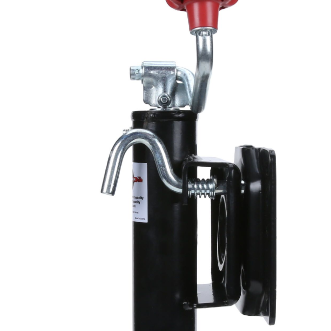

It sure seems to me that I should be able to cut the existing jack off, and simply (nothing is simple, but I'll adapt) weld a square one in it's place on the swivel. The overall lengths seem to be about the same. As long as the foot is no larger than what is on the present jack, I don't see why this might not work. Am I missing something?
I'd use something like this: https://www.tractorsupply.com/tsc/product/bulldog-heavy-duty-topwind-square-drop-leg-jack-with-base
I'm open to other jacks, but it seems the market is pretty limited in what is available...like all are made by one or two companies, just rebranded.

Glad to hear it's not a big deal to use those square tube Jack's on a swivel mount. For the life of me, I cant understand why the drop leg isnt more common even on the swivel Jack's. I guess most people use their trailers on level ground? In some places I run out of jack travel, and in others I cant even swivel it into position before it hits ground.

I'd have to price them out, but it seems what I'd think to be a more stout 8k jack with drop leg is cheaper than going with a 2k jack and the add-on drop leg. Potentially less work though, if the swivel mounts are identical and I can just leave the swivel mount half already welded to the trailer...

I bought a swivel mount one, and then later when I rebuilt the trailer I did a drop leg bolt on.
That's not that bad price-wise for sure. Seems relatively compact too. Length could be an issue as short as the tongue is on this trailer.
I assume those are decent Jack's people dont see a lot of problems with?
Any advantage to side or top wind?
That is the style swivel we use on our trailers at work. Just replace jack if jack fails, no grinding and welding. The knuckleheads at work normally hit them on something, so I haven't seen the screw fail.
