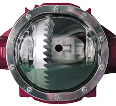

After my "gov bomb" incident I would like to keep an eye on things.I want this cover and was wondering if anybody is running it?It's made with kevlar so it is strong,they say as strong as the steel ones.
They say it crushes but pops right back out. Don't actually know anyone running one. only issue with that is it will hit the ring gear if it crushes in.
Well, if it actually does crush in and "pop right back out" I wouldn't run it. Think of backing up against a big rock, the cover crushing in while you're still on the gas, and a tooth on the ring gear getting a hold of it. :eek1:
id run it only if i had one of the tube skidplates just to be safe
While somewhat of a novelty, who cares?
Stop running axles that are coming apart and you won't be worried so much! :)
Seriously though, I don't see the point of being able to look at the diff (especially if you think there is enough of a problem to inspect it) if you aren't going to change the fluid.
Don't get me wrong, it does look neat, Just not something I'd personally spend money on.
BTW, sounds and looks like Lexan to me, not Kevlar.
I wouldn't want one cause your gear oil will only look like that for one mile, after that it looks nasty like the Loch Ness :haha:
If I were to run one I would have a rock ring with the ring guard, like the one from poison spyder, that way you worried about it getting damaged.

I agree - a few miles and you would see nothing more than with a regular coverexcept for maybe the fluid level. Just check it once in a while and it should be fine.

These ClearGearz differential covers from Trans-Dapt Performance are clearly a smart choice all around. The transparent covers not only look extremely cool when installed, but it also allow you to inspect for abnormal gear wear, oil levels, and for contaminants that could ruin your gears and shorten rear-end life. The polycarbonate material is the same material used in bulletproof glass, and is as impact-resistant as steel, but cleans easily with soap and water. They feature a metallic, ceramic-coated steel mounting flange that looks excellent and ensures gasket rail integrity. All covers include necessary bolts and washers.
It's a polycarbonate of some kind for sure. Kevlar is a fiber, and wasn't available in clear the last time I checked.
yep, cool polycarbs. Not doubt its stronger than a stock cover... but I don't see much point in spending the $. A GreatLakesOffroad cover is $110 and pwns that thing.

Glass is stronger then steel too, but I don't see any glass covers. :rolleyes:
Seriously though, stronger usually means more brittle as well. It's one of those generic "that could mean anything" terms, like faster/better/etc.
Just like a fiberglass body panel, one crack/gash/snag and it's a $130 paperweight. For that kind of cash you can get some serious diff armor. Or put that as a down payment on a beefier axle. :waytogo:

it is a cool idea just seems better suited for a show truck or an educational display than for use on a trail rider

I agree. As for the "claims"... I don't think it would make "checking for gear wear" very easy, when you can only see some of the gear. Like mentioned, the oil will be pretty gnarly looking real fast... nothing cool about that. About the only thing good.. if you got a lot of water in the diff, you would probably see that well enough. You probably won't be able to see through the cover until the truck has been sitting at least over night, or close to as long.
