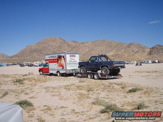

I hauled mine from NY to Georgia on a Uhaul trailer. It is my understanding from speaking from Uhaul reps that there is an older version and a newer version trailer. The older being the bigger one and shown in this pic...
The newer being this one...
When you call to reserve a trailer they can't guarantee which one you get though. I made sure i was getting one of the older ones. The only problem I ran into was having to air down the tire almost completely to get the Uhaul straps over the front tire to secure the truck to the trailer. Once I got the straps around and fastened I aired the tires back up a little. I think the tires were a 285/16
