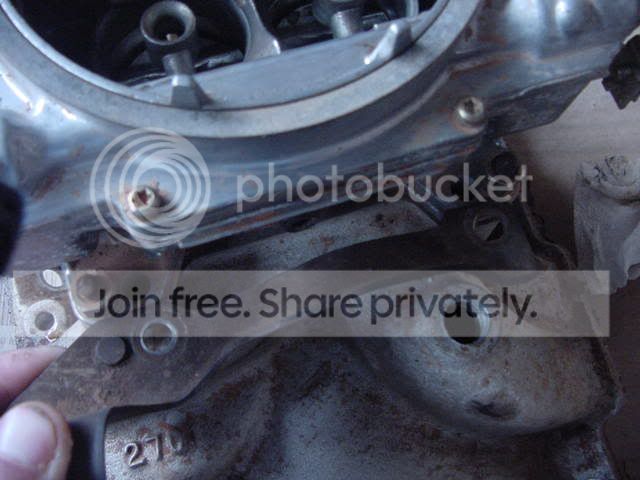

Was gonna swap on my throttle bracket onto my Ebrock manifold and carb today. The bracket goes under the 2 back bolts on a q jet. There are 2 sets of bolt holes in the e brock carb, but the manifold's holes are the outer two holes. This creates a problem with using the stock bracket, as it was designed to use with the two inner holes. Any body alter this bracket to make it work? I have run through a few ideas, but haven't decided how I will make it work yet.

I will take a pic tomorrow and show the problem. you will see what I'm talking about. if anybody has a pic of a modified bracket, I would love to see it, since I've only got one to tinker with and want to know how to before I go cutting/weding/bending/drilling.

I could tap that nipple out and make the hole bigger, and extend it on the other side with a strip of metal so it would fit in the second stud hole.......... anybody got pics of how they modded this bracket?

do you have an edelbrock manifold or a quad manifold? the edelbrock intake only has 4 holes, and those are the outer holes.

Called Edelbrock today.. I don't have the origional Performer, I have the Performer EPS (Edelbrock Performer Series), which only has 4 holes........ So I'm back to the drawing board.. I really really would love to see some pics of how people modded their throttle brackets..

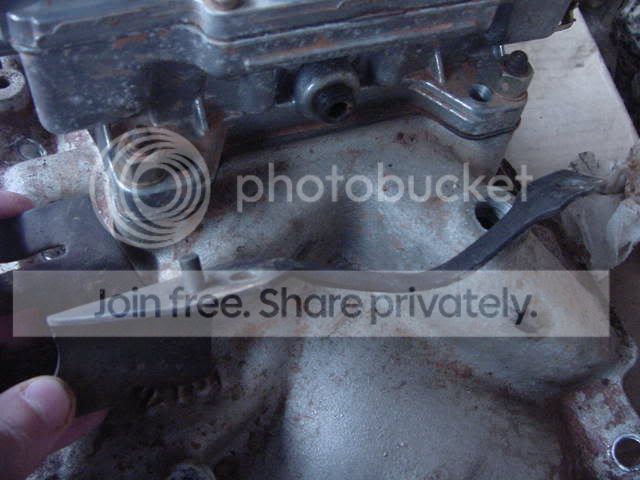

Here's mine I just cut this one off to use one bolt, I used a lock washer and nut to hold it in place been like that for years, no problems or movement.
backyardbuilt,
I appreciate the picture. The zip ties seem like a good idea to take some of the stress off of the bracket. I'm thinking I may not have to cut the bracket at all, and just use one of the holes (the one right by the nipple). I would love to see any more pics of brackets like this.
