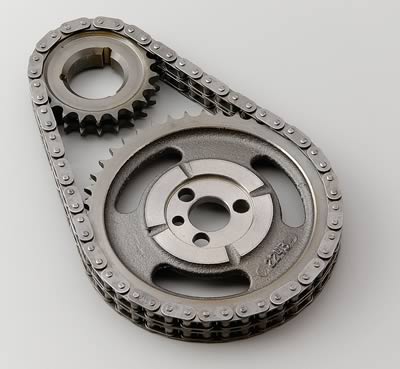

A machinist budd of mine suggested installing a new timing chain and gear set. He suggested Cloyes kit that has the advancement/retard built into the gears.
This is the roller kit I am going with. Summit number CLO-9-1100.

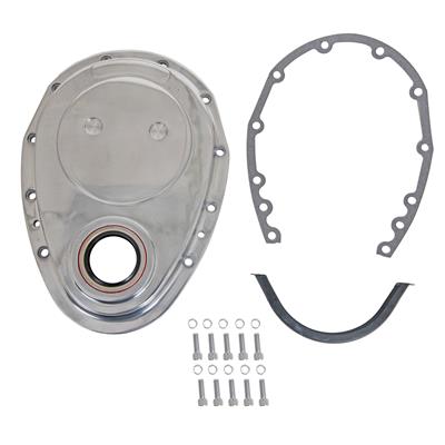

Also got a cool aluminum cover -

He said to try the 4 degrees advancement and the should help with the bogging down off of idle.
Anyone have experience with this? He said it should really boost lower end, but at the sacrifice of gas mileage.

Just installing a new timing set can boost performance. Stock chains stretch, never torn down a small block that didn't have a stretched chain. A nice Double roller could gain you some HP and maybe torque, depends how stretched it is.

I pulled the timing chain cover last night. I measured about 5/8" slack in the chain from side to side. I talked to my machinist buddy about it. He said that's about average that he sees. He said it would be really bad if the chain was hitting the cover - and is was not.
He said the 5/8" amount of slack could cause up to 15 degrees of retarding to the timing...
Anyway, I have got to get a puller to pull the lower crank sprocket off and I will be ready to go with the install...
