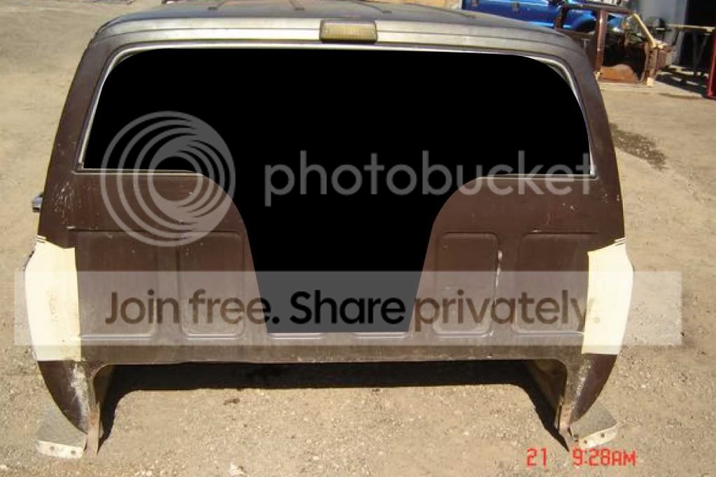

I want to be able to wheel with my wife and daughter and I also have a son on the way so I'm trying to come up with a solution to my 2 seater truck problem. The idea i'm kicking around is to cut a portion of the back of the cab out and weld the box sides to the side of the cab and mount the box on poly bushings then have a soft top made.
I basically was thinking about cutting the cab like this (see below) and bending the cage to match these lines and welding it solid. This would create a pass through for passengers to get into the bed of the truck and still keep the B hoop pretty solid I think.
Thoughts, comments, concerns, gripes?

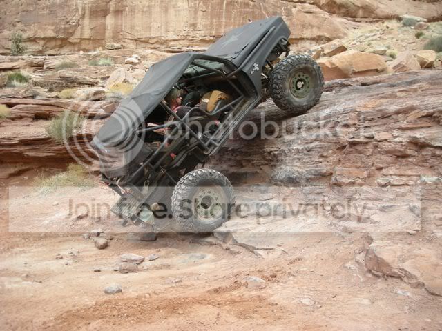

This is what I am going for, eventually. If you look at my build very similar to yours. I started with a k20 longbed as well.
