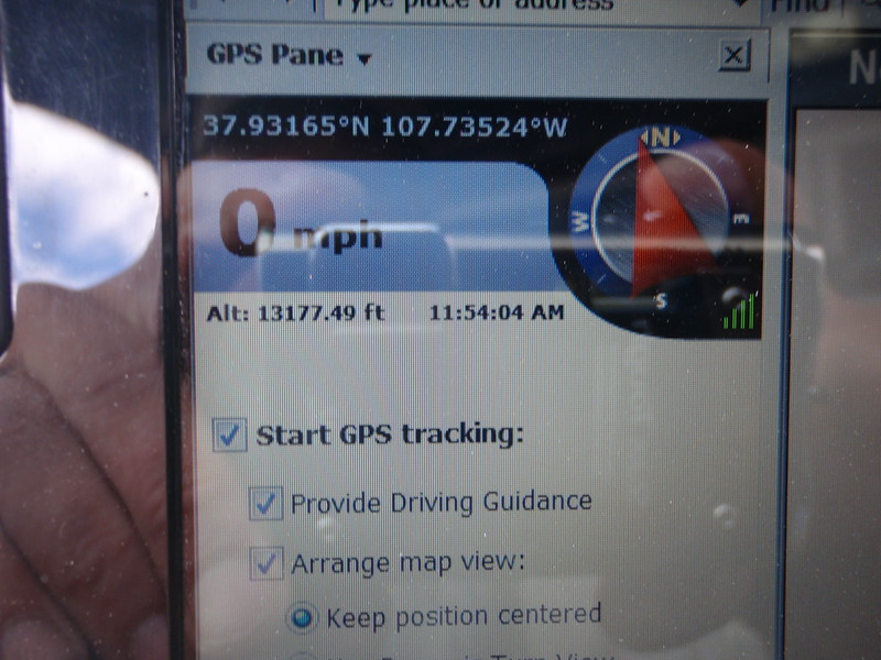

Altitude alone is one main reason I always opt for the largest engine in anything I buy or swap. I noticed a huge power gain a few months ago while playing around Death Valley then noticed the power continually getting lower the closer I got to home, especially climbing over Wolf Creek Pass. Out here in the West is it nothing to drive over 7,000 ft. in elevation in one day. Leave home at 5,000 ft. and cross over the continental divide to camp/fish a few hours later where it is 13,000 ft. If there is any good excuse for a big block, altitude is a good one :whistle:
Altitude changes is where a diesel, or any turbo engine for that matter, really shine as altitude doesn't affect forced induction engines as badly.
In Death Valley a truck loaded to 8,000 lbs with an 8.1L runs like a rapped ape burnout.
At 13,000 ft. not so much....an 8.1L runs more like a 5.3L. Just imagine how those little engines feel when playing in the extreme altitudes :doah:
