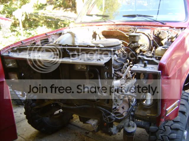

I don't know about you guys, but I'm the kind of guy that if I spend too much time thinking about a project I end up just going in the garage one night and start cutting. Thinking it'll all come together in the end somehow.
So here I am with 9" cut off the passenger side of my core support and a big relief angle cut into the inside of my fender just forward of the firewall.
So far so good. I'm not too worried about where I'm gonna put my head lights and batteries for now. Thats some other days problem.
What I wanna know is who has done this and how have you gone about reconnecting the fender to the core support.
I've seen some build threads on here that have had this done but no detailed pics of that connection.
Due to the way the sheet metal contours on both the fender and core support, I was thinking about being lazy and just welding L brackets in from the hardware store but that seems jenky.
Has anyone done any sweet custom sheet metal work on this that can enlighten me?

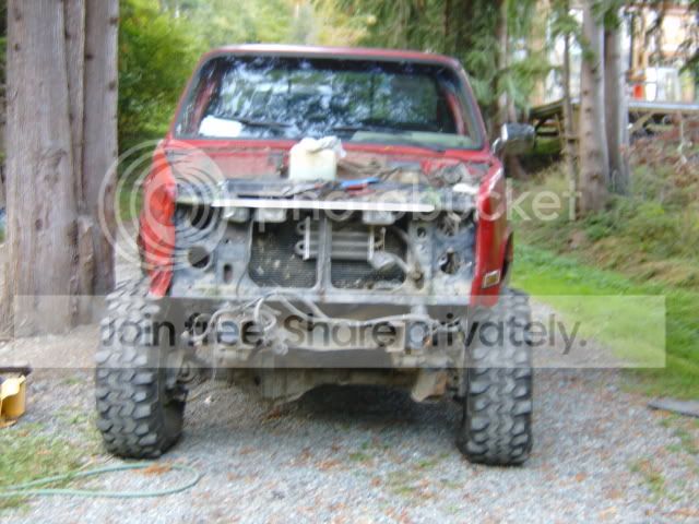

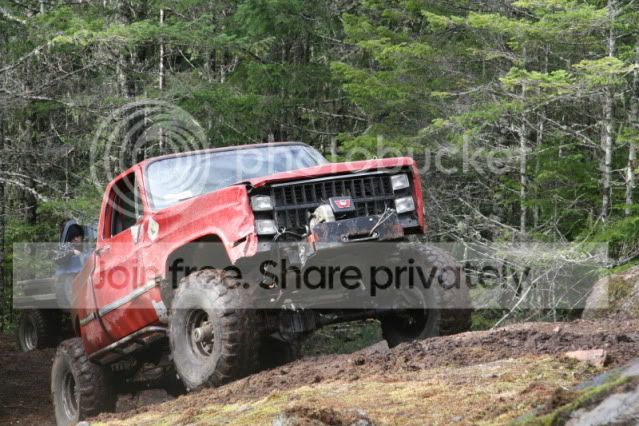

I just cut an 8" section out of both sides and pulled it all together and welded. No relief cuts or5 anything. It's pretty rough though but the whole body is rough. It gets beat so it's good enough for me. here's a couple pics.
Hey thanks, that's a much better idea. Plus I get to keep the headlight buckets. I'm not done with it yet but it seems to be coming together quite well. Next thing is the wheel wells. Where those hard to get cut into the right shape afterwords? And how about the hood hinges? Is that a lost cause because of the new angle. I was thinking I would have to go to a four hood pin design and just have to lift the whole thing off whenever I wanna gain access.

The inner fenders are pretty easy to cut, just take off small sections at a time so you don't overdo it. I found the hood hinges to be a lost cause because you have to cut out the mounting areas when you cut your hood to fit. I went with the four hood pin style and like it.

I still have my hinges but springs and brackets to hold the hood up are gone. As for fenders I bent everything in and cut as I went.
Like I said mines rough but works.
