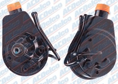

trailer queen, no street driving here. I bought a pump on a gamble off ebay. Its a reman ac delco and seems to be one off a hydro boost van so needless to say im going to have to change the lines. More of a "while I was there" deal. Here is the pump I'm trying out as mine is shot. This is a last ditch effort before shelling out $$$ for either a KRC pump or full hydro system. 44s and low air pressure off road has not been my friend.
I don't know if this pump is going to work or not, but am hoping so.
