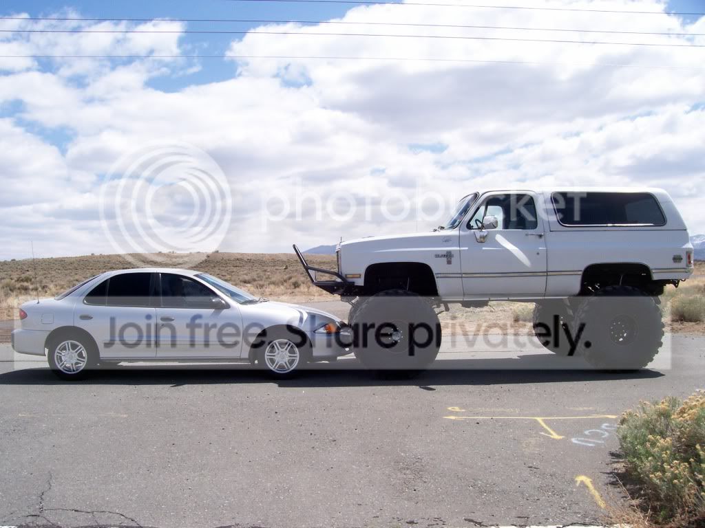

ok, here is a pic of the springs with the shackle hanger moved from stock to a more forward position (pretty common with stock 52's, like in JEK's write up on the home page) and i also ran the b-52's in the forward most position on the frame and the front spring bolt in the forward most hole. as you can see the rear part of the spring is buried in the frame.
i dont have a great current picture, but i moved the rear shackle hanger back to the stock location, kept the b-52's in the forward most position on the frame and move the front spring bolt back one hole towards the rear. the shackle angle is a ton better, but might not be ideal for some people.
