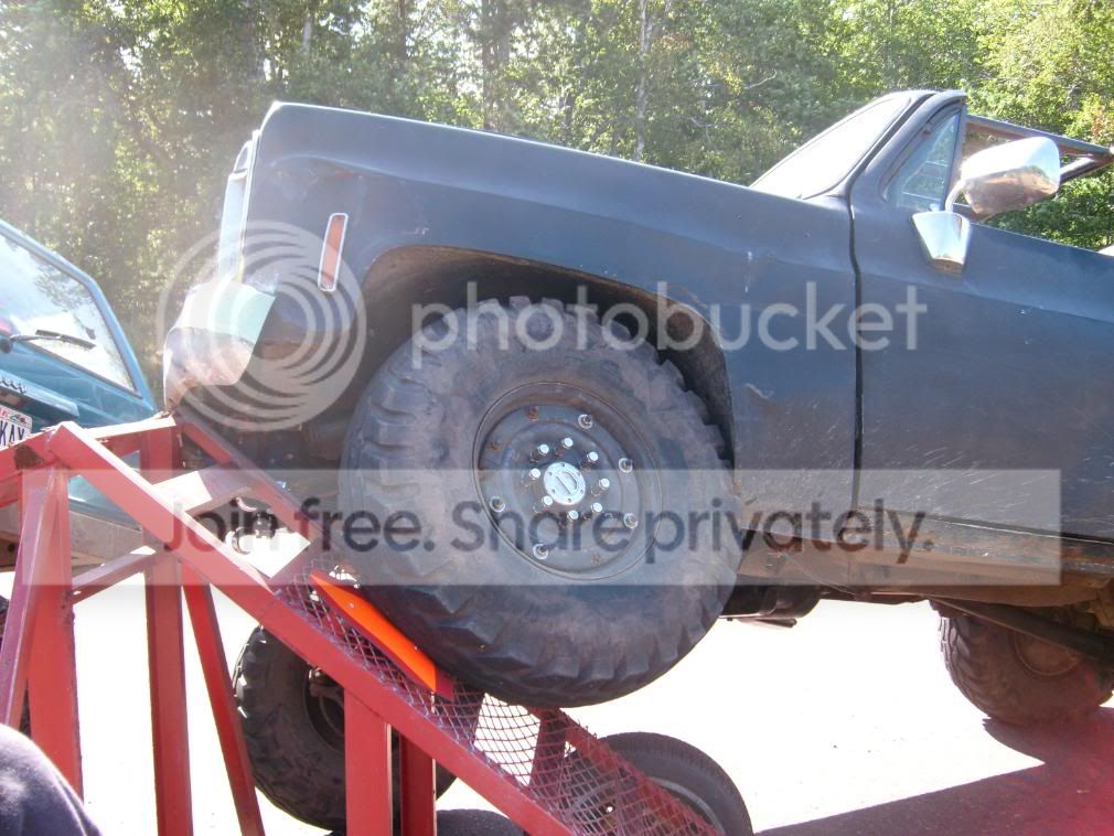

Here's mine partially flexed out.... It could have went more than that.
Stock 52's > Stock length lift springs.
