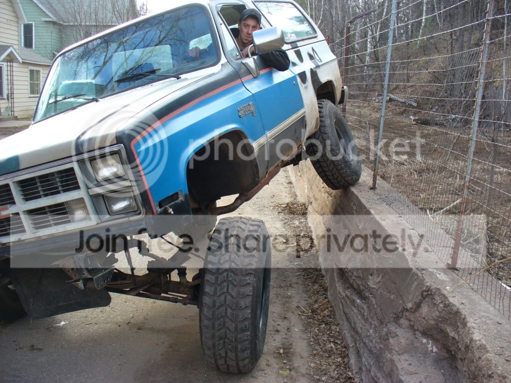

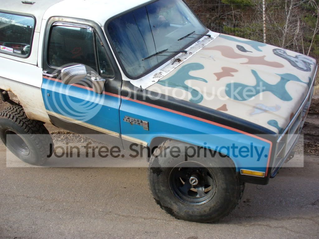

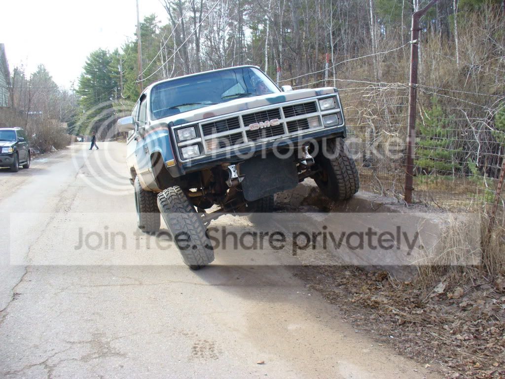

I just finished swaping 3/4 ton axles and 52 inch springs into my K5, I got my B52 kit and shackle flip from DIY4X money well spent. If you are looking for sturdy high quality parts he is the guy to deal with. I used a 7 inch shackle and 5 leaf pack with overload from a 85 half ton. For the rear I used a 4 or 5 inch cros tied shackle. Here are some of the pics.
crossover is coming very soon. Just waiting for DOM and a few other things. I have F250 shock mounts sitting in the garage to be installed. For the rear I am thinking of using an S10 spring plate plate with the shock mount right on the plate already
