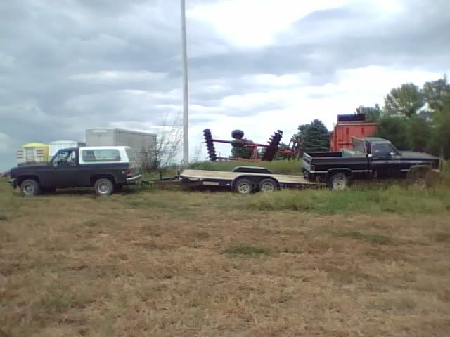

and how much did the trailer weigh, 1500-1800 lbs? in addition to the 6-7K?
Maybe, it was a 16" trailer rated at 7500 lbs, might be 1000-1500 lbs
i think this thread was answered so......tongue weight is probably the most important behind trailer brakes. too much and you can't steer or stop, too little and the trailer sway is bad.
djtejas, a 700+ (at 10%) pound tongue weight without a weight distributing hitch is not a good idea...did you use one?

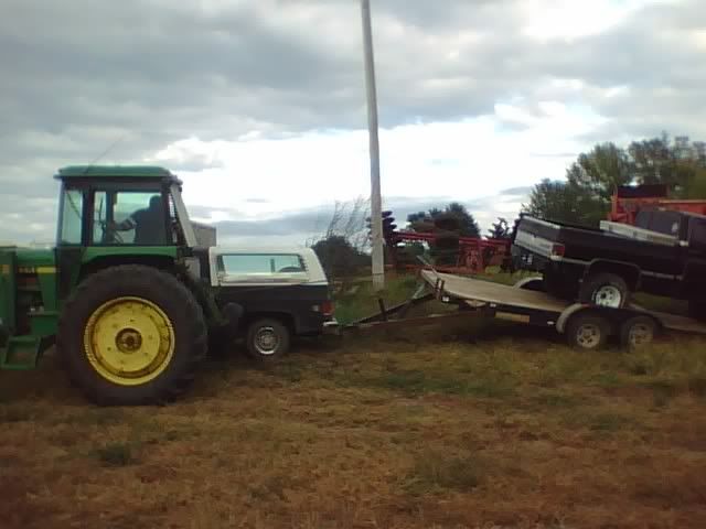

With the 3.08 gears, this was all it wanted.
Martin
hahahaha
I was wondering when someone would comment on that. That truck had a blown rear axle that was locked up. We had to use a tractor and a come along to drag it up on the trailer. Luckily I only had to pull it a couple of miles.
