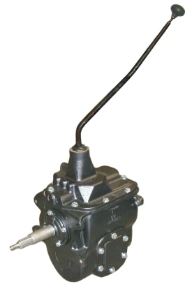

Here's the Novak conversions information: Since it's including military applicaitons it must mate to something.
The Novak Guide to the
GM Muncie SM420 Transmission
The SM420 is an impressive, heavy-duty truck transmission designed for and used in ½, 3/4, 1 and 2 ton trucks. The SM420 was made by General Motors from 1947 to 1967. Military specification versions were made through the early 1980s. The SM420 is found in GM trucks, busses, heavy equipment and various military applications.
The "SM" in the transmission's designation stands for Syncrho-Mesh, in the tradition of other GM gearboxes, though we have heard that it may refer to Stewart - Muncie, a merged transmission division of GM.
Features
The SM420 is a top loaded, top shifting truck style transmission. It enjoys the lowest compound gear of all the common truck transmissions at 7.05:1 and as such it is a popular choice for those wanting a very low crawling gear.
The SM420 features a power-take-off (PTO) port on the driver's side of the case.
The SM420 is fully synchronized in the second through fourth gears. All gears are helically cut except first and reverse, which are spur gears.
