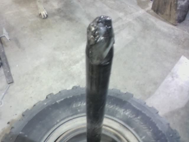

35's aren't THAT big of a tire, but the problem you should be worrying about is what happens if you DO break something? Up front, snapping an axleshaft means that you can still limp it home....snapping a shaft out back means that your wheel is going to fall off and leave you stranded.
The biggest benefit of the 14BFF is the full-floating hubs. If you snap an axleshaft (not likely) the wheels will still stay attached to the truck, and you could still get home in FWD.
At the very least, I'd look into any aftermarket kits that will allow you to convert the rear axle you've got to a full-floater, or at least something like a "C-Clip eliminator" kit to keep those wheels in place no matter what happens.

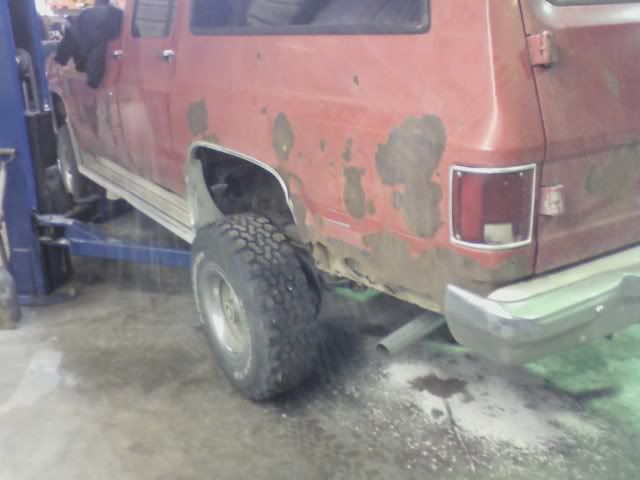

Just think about how bad a 35" tire coming off and getting jammed up in your wheel well or having it pass you going down the road will ruin your day (and mess up your burb).

As the others above me said, use a full floater in the rear. A semi floater will leave you stranded and you will either piss off yourself or your friends.

yeah, just run the ten bolt. If it has a gov-lock, then start axle shopping soon after the 35s. If not, just keep an eye out for bent axles, diff noises, and don't drive like a madman with a pissed off right foot.
My rear 10 bolt had the gov-lock and 60,000 miles on it. I abused it a couple times a week for six months before it actually locked up. (manual trans and 33x12.50 tires.)

One thing I learned with my Blazer project is that your running gear can have an affect on your power. I swapped in a Corp14ff in the rear, D60 up front w/ Dedenbear knuckles, crossover steering, doubler transfer case, and HAD shafts with massive U-joints. All of this adds a lot of weight and now my engine just didn't have a ton of power to push it all. I have a crate 350 that came with an Edelbrock Q-jet and intake. I added Doug's headers, an MSD HEI, and just put in a torque cam which helped a lot. Of course I also have a full roll cage but I also gutted the interior. So, in summary I would also consider your engine and whether you currently have enough power prior to adding a whole lot of rolling mass and more weight.

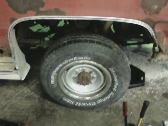

This is with 31x10.5x15" tires.
For as stupid easy as swapping in a full floater is, I don't know why you wouldn't? (I did)
