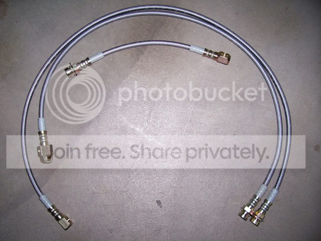

I've been getting ready to do the whole brake system on my blazer, and i was ready to go except for some custom s/s DOT approved lines. My first idea was to go through blackwidowperformance.com, but i haven't heard anything about them recently, and i wasnt sure if they re-opened. So i went out surfing the web and found out about this company called G&J Aircraft and Competition, located in ontario, CA..(909)986-6534.. so i called them up i told them what i was looking for, which were five lines, two 38" long lines up front, two 10" lines for the rear disc, and another rear line with a "t" fitting 31" long, all for a little under 130 shipped. They also said the would build them and send them out as soon as i got off the phone. Well two days later i received these:
there are two lines not in the picture, but you get the idea, and this pic really dont do these lines any justice. They seem to be top notch, and the company was real easy to work with. Anyways, i thought i would pass this along to you guys if you are ever in the market for a custom set of lines that are DOT approved and not to harsh on the wallet.

yep, these are the lines for the truck in my sig. When i called i just told them the length i wanted (38") and a 3/16" I.F. at the frame, and a 10 mm banjo (this is the front line with a dana 60/ corp 10 banjo size), The rear long line was a 1/4" I.F. fitting at the frame with a 3/16" t-out.. and the short rears were 3/16" I.F. at the axle end, and 7/16 banjo (I'm running 77' calipers and this banjo is for the older, pre 78 or 79 chevy 3/4 ton calipers).. just make sure you know what year calipers you run in the rear.. and if i'm wrong on the years, hopefully someone will chime in on the correct years. hth

What i did was go down to the local parts store, (napa, car quest, etc..) and i grabbed an assortment of union fittings, (3/16", 1/4" etc..), which cost me about 3 bucks, and then i went and did a test fit with them and once i knew i had the right size fitting for the hard line, i told G&J that i needed a 3/16" at the frame for the front lines, and a 1/4" at the frame for the long rear. the 7/16" and 10mm are the banjo bolt size fittings which tie into the calipers..
