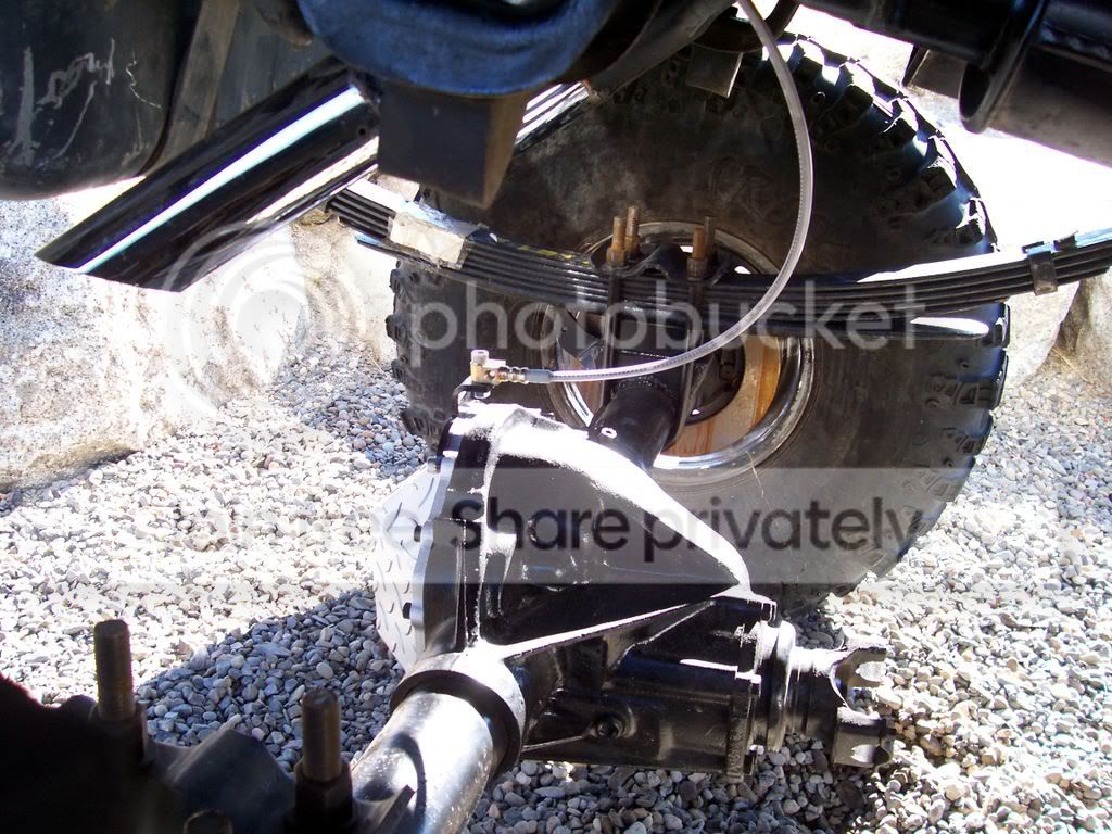

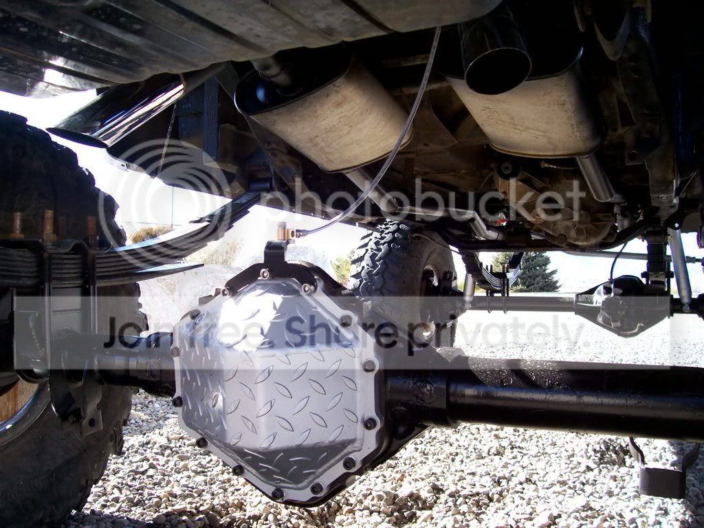

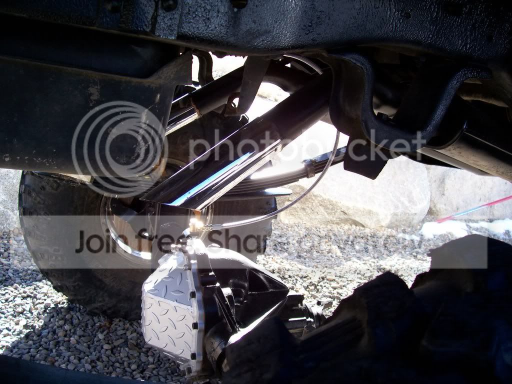

here is a pic of the rear line i mounted this morning, i will have all the pics up this weekend after i get the calipers on. These should not limit flex..lol
