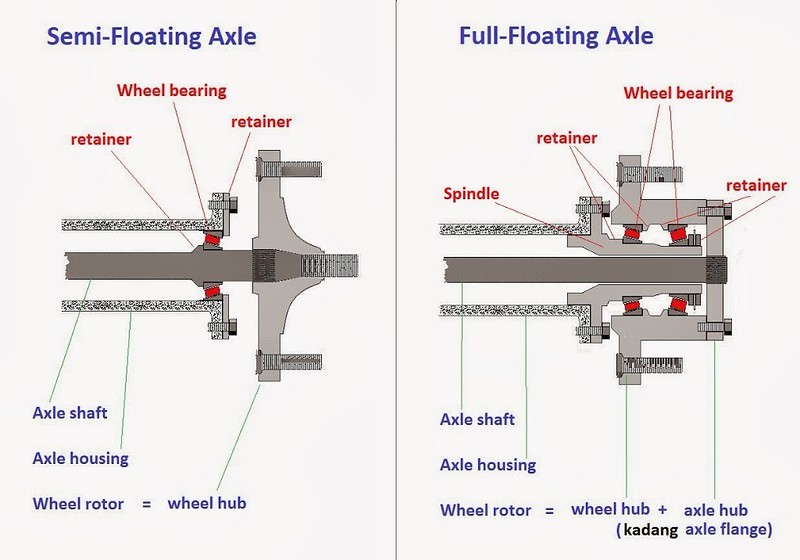

If you want to run 6-lug, the 14B s/f (9.5" ring) is the best choice. If you will go 8-lug anyway and will run bigger than 35" tires, you might as well look for the FF (10.5" ring). The price of either is the same, but the FF axle is much stronger. However, the ground clearance with smaller tires is kind of silly off-road. Swapping the front end from 6-lug to 8-lug isn't very hard. Also, selling your 6-lug wheels and buying 8-lug wheels isn't necessarily a big expense.. You need to search this site for information on both axles. Pretty good gearing and locker options for both.
Basically the FF puts the wheel on a hub that rides on dual tapered roller bearings on a spindle. You can remove the axle shaft with the hub and wheel still bolted to the axle. The shaft is bolted to the hub. In the SF, the wheel flange and axleshaft are one piece. In GM axles, the shaft is held in by a c-clip (not a retainer as shown below) inside the differential and rides on a single roller bearing pressed into the axle tube
I've wheeled a semi float on 37s and a locker for a few years now pretty hard... Never had an issue with mine, but I am going to a full float because I have it and want to go bigger.
@Richcz28 broke an axle shaft in his semi float and had to be drug out of the woods.... it was interesting trying to find a 6 lug axle shaft so he could get home the same day. Just keep that in mind.
right and a full float.. you can drive home as the axle isn't holding the rear tire on. that is the super benefit if it is a ... drive to the trail.. rig
