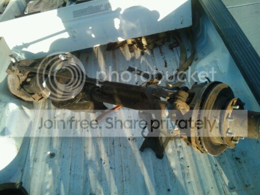

I took a gamble and waited until I had more time and helping hands... I got it pulled this morning! 150 dollars it was mine!!! :woot:

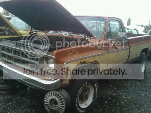

It came out of this truck. A gmc seria classic 25 camper special. Didnt even know those came with a dana 60
THIS MOFO IS HEAVY!
I dont even have anything to put it in at the moment, :doah:But the deal was to good to pass up!
they didn't come with them
1 of two things ..
wrong fender badges
or
swaped in to that truck.
Nope! Wrong! This actually and FINALLY the very first K20 I have ever seen that came with a D60 front.
I remember reading somewhere years ago that very few K20's that were camper specials had D60 fronts. Yep, I didn't believe it either but that quote stuck in my mind forever because I wanted to prove everyone wrong. I was on a roll until this thread popped up along with the pics to show it. Now I've been proven wrong and here it is, the ultra rare K20 with a D60 front! :bow::waytogo:
And I'm gonna stand by this quote until we see the actual fender badges, RPO sticker, build sheet, etc.
Meanwhile, pics of the brake booster should be posted along with a pic of the rearend so we can see which u-bolts are under it and where the shocks mount.
The OP needs to repay his debt to the d60 gods for getting such a great deal by documenting this rig with photos for the masses...:D

Now you got me confused ha. But that truck was loaded with cool features from what I saw. I didnt look at the brake booster, but it did have factory cruise control, a/c, and a factory tack but somebody already took it (factory wiring harness was still dangling in place).
The rear end was just a 14bff, are ubolts different on 1 tons?
Right under the camper special badge it said gvw 8400 if that means anything
