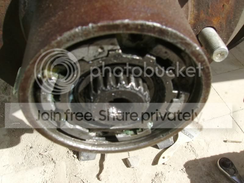

Same issue I just can't get the stub shaft to pop out enough to get the snap ring on. The pic is with a prybar holding the stub out as far as it will go. I need at least a 16th to an 8th inch more to get the snap ring on.
Is that the model where part can be put on backward?? I remember someone else having a problem with a hub that would not engage and they had it assembled backward.
I'll see if I can find that thread. Not sure if that would cause your problem, but it might.
