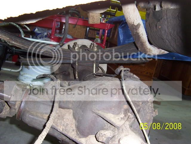

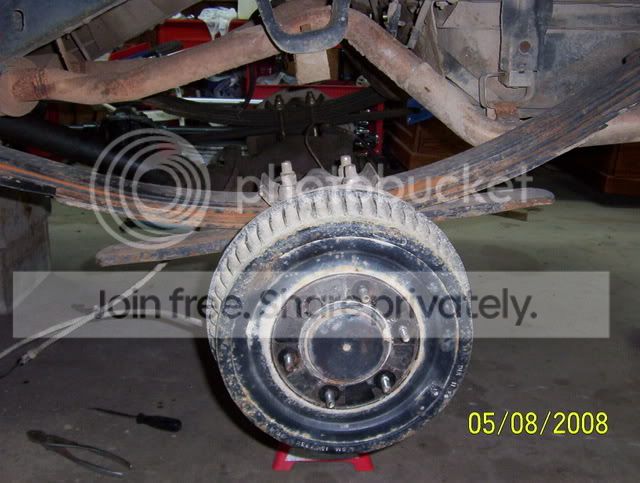

Just got a little done tonight, got everything unbolted from the rear 10 bolt except the leaf springs. 6:15am comes early.:crazy:

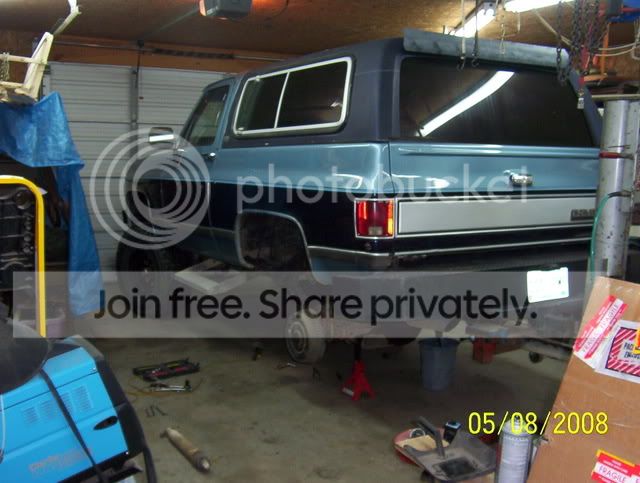

Yeah, two tone blue brings da pimp.:pimp::D
Only real blemish on it is that damn spot below the driver's side tail light, can't remember exactly how I did it, I think the stock bumper rubbed it some how.:confused:

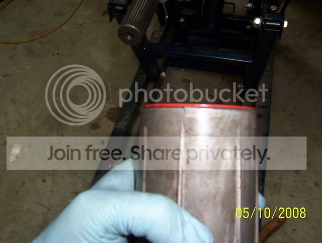

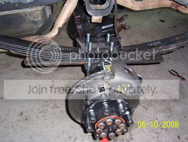

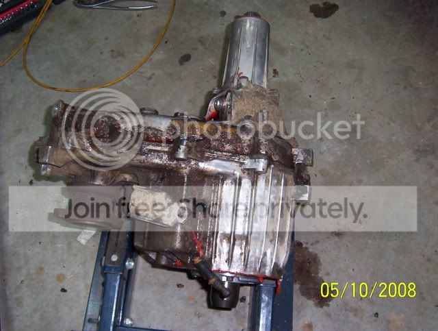

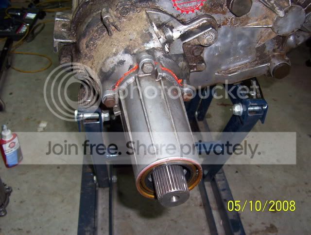

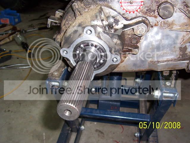

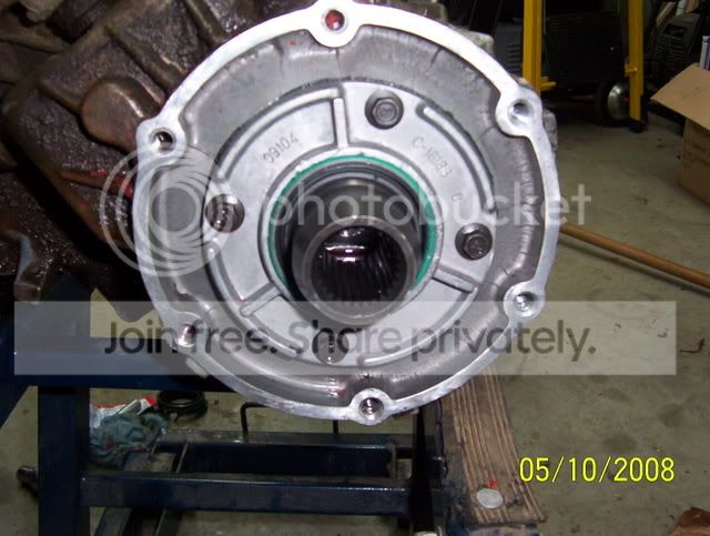

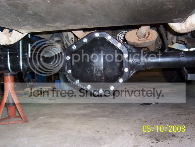

Got the 14 bolt bolted in, pulled the transfer case, replaced the input seal, tailshaft housing, and put it back in. I'll get the rear buttoned up tomorrow after mother day business hopefully.:D On to some pics.
Sucked lifting the damn case by myself but at least it's not an iron one.:crazy:

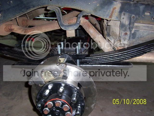

the disc brake brackets are supposed to be on the back of the axle. did you mount yours different for a particular reason.
Not really... I think I recall people saying it doesn't really matter... I just wanted the bleeder screws sticking up.:confused:
Yeah Matt, but have you taken it out and put it back in solo style?:D
I've always interpreted "up" to mean the caliper is more vertical and the bleeder is point like STRAIGHT up:
That's on my dually, but ignore the rotors and it's the same as yours.
-- A
Very noob question but could you put the diy bracket to the back and swap the calipers to the other side??? then the bleeder would still be pointing up and the caliper to the rear.
OOOOOOOOOOOppppssss. I set mine up the same way. but because one of my trucks with rear discs had the caliper more on the front side stock. Don't remember what truck it was now. That and it seemed like they were more protected. Oh well they can always be moved if I don't like them.
If you don't have a parking brake setup -- i.e you're not using Caddy calipers -- you can put them on either end.
As mine are the Caddies, I had to put them on the back of the axle so that the parking brake cable would pull.
