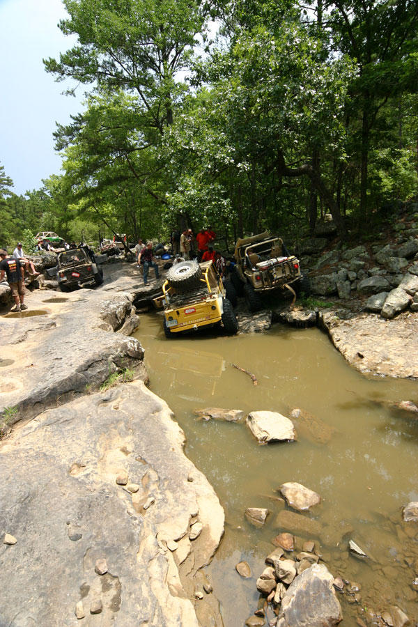

You guys are crazy. There is a CLEAR and up close shot of Stephen's rig in this pic. :rolleyes:
In case the pic doesn't work.
Oh ok, Stephen was leading the Pack and the Camera man couldn't catch up to him. I see :D

The one hobart site pic with wally in the background is where they were welding up the track bar mount on the yellow jeep at the base of the ledge that only wally got up. That was one of the "big bumps".
